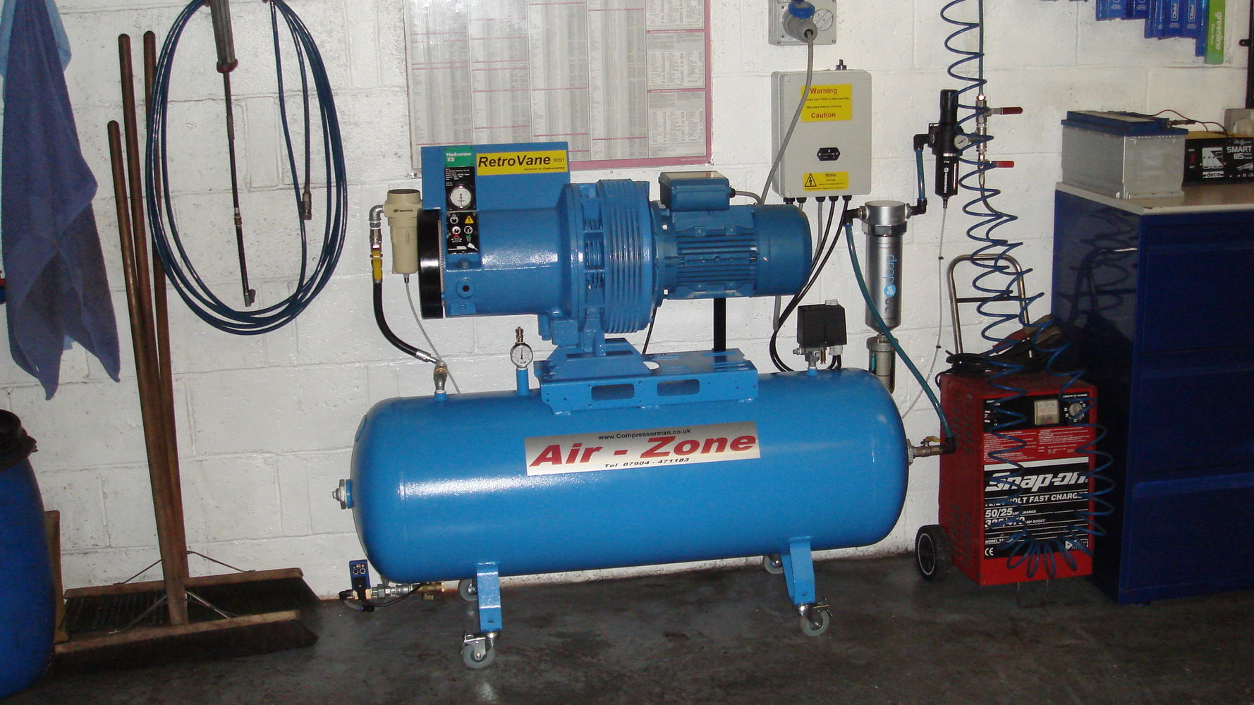

I have a Hydrovane v01 3 phase compressor and want to run it with a yl600 vfd. Anyone any advice on hooking up the pressure switch to the VFD?
Less than a piston compressor I would say?Pull on a hydrovane is huge, you’ll need a good VFD to start one
1.1kw The vfd is 2.2kw. The set up I have should work fine, it's just setting it up is the issue
Same thingTrying to decipher what are the ramp settings. Is it frequency rise time
Or
Acceleration?
Ah, auto unload. Find a way to add a timer to switch it to stop.."Inrush" - start up current is not gonna be huge for 1.1kw.
Why do you want to "cut it in and out" on a pressure switch? Just let it run - once the Hydrovane airhead is up to pressure - it will "oil divert" and not pull too much current at all....![]()
Is that on a vfd or dol?Ours pulls a tonne of current, on three phase it will trio a standard breaker 32A
