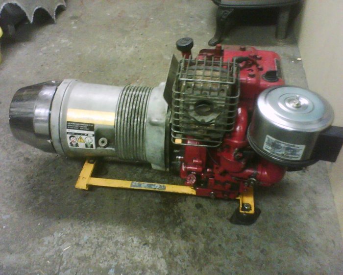

ive just been given a petrol driven hydrovane 15 compressor thats driven by a briggs and stratton 8hp petrol engine...it was original in a genny style cage but was removed to fit into the back of a service vehicle thus no receiver.
my question is...
can this be run continuously without a receiver while hooked up to air tools..

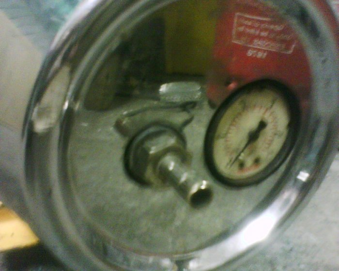

ive fired it up using a small length of air hose with a blow gun on the end and the compressor climbed quickly to 120psi then held the same pressure with little or no change until i blasted some air out the gun when the pressure dropped to about 100-110 psi...then on release the pressure jumped straight back to 120psi..
am i right in thinking this monster is meant for constant use without use of a receiver??
cheers for any advice in advance..
