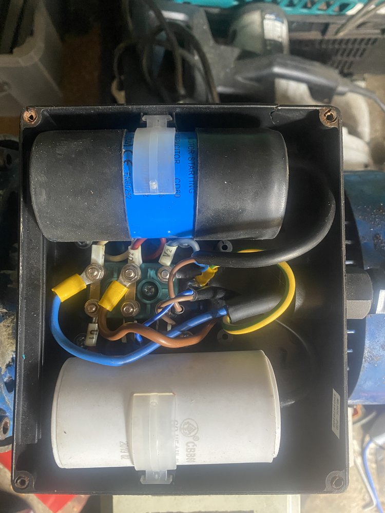

i'm new in to the form! i do have one hv2 Hydrovane, that i bought almost a year ago, and not sure what's wrong with it.

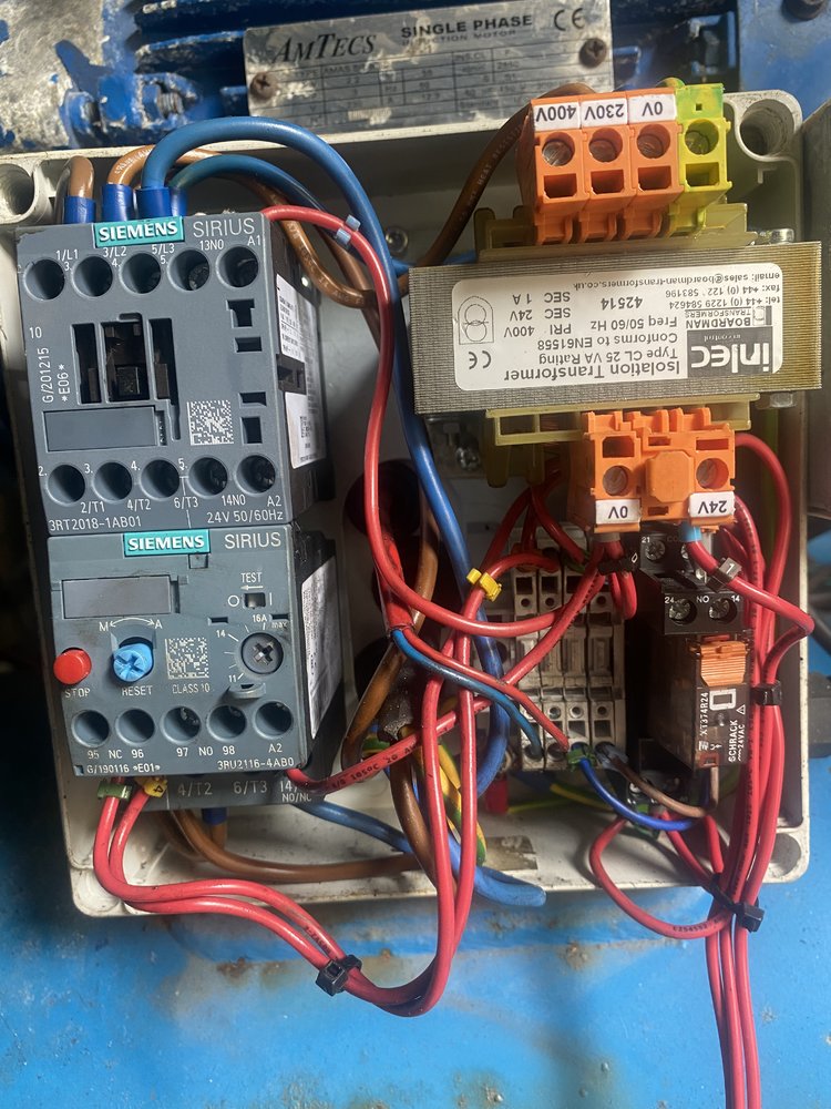

I did separated the pump from the motor to see if they run freely and they do but the fuse on the plug keep blowing, i use a 16am converter cable and up the fuse to 16 but now the fuse board switch trigged

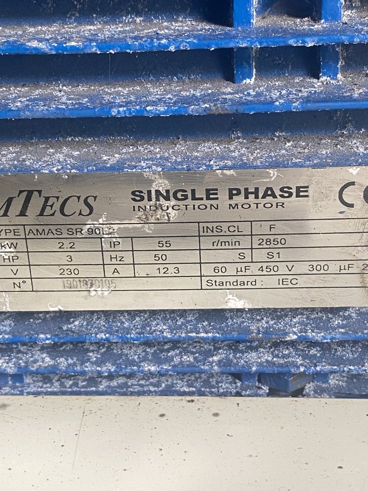

is the 2.2kk (2200w % 240 = 9.16Amp ) ia a 13 amp fuse not sufficient ???? or how i can test the component or if there is a compressor mechanic or engineer in camberley area GU15 surrey i'm happy to pay for the service
