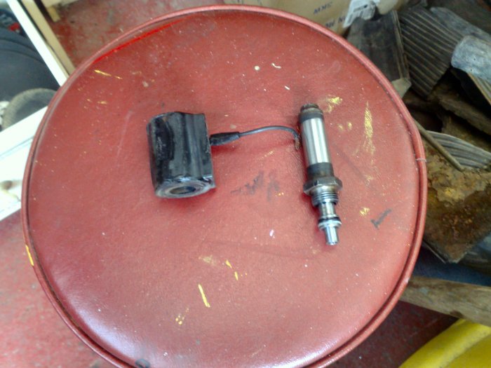

The multi meter went to 1 when I set it to ohm I then connected one probe to wire coming out of it and the other to the casing of the pump that it was screwed into and nothing changed thanks Chris
There is only 1 wire from the coil please see pic thanks Chris
You need to check for continuity between the 2 wires from the coil, there is no electrical connection from the coil to the pump body.
Hi Paul I assumed that power goes in the one wire and makes the connection to earth through the pump body this coil definitely only has one wire as you can see but I have been in touch with fluidlink for a replacement and the replacement has 2 wires one to be connected to earth and the other live Chris
