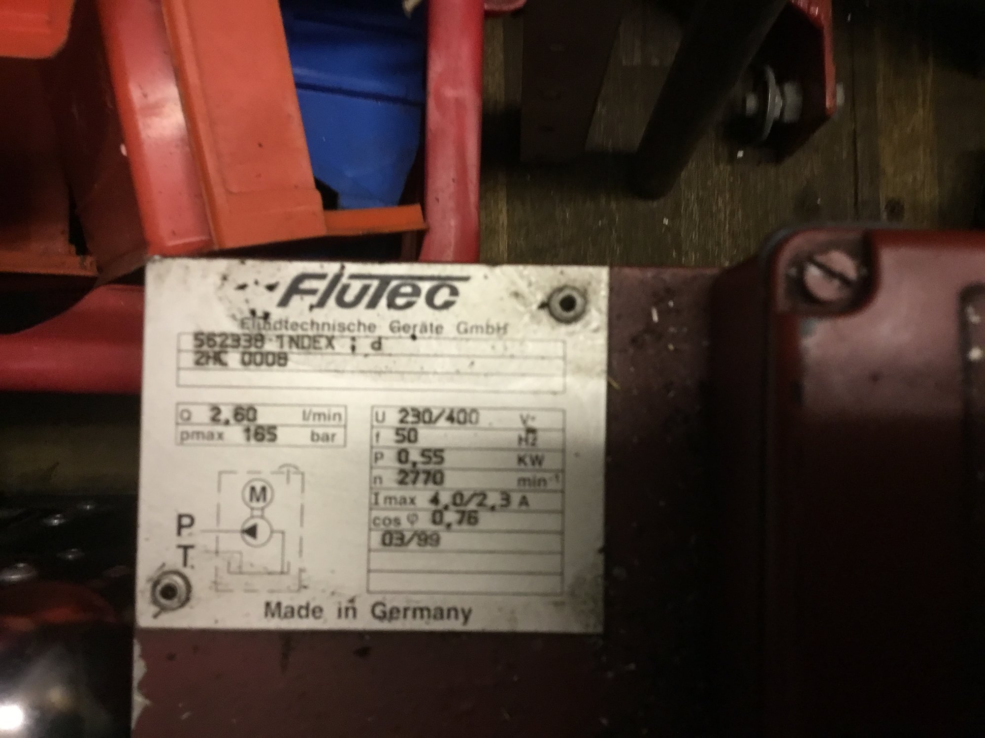

Got a problem with a Hydraulic pump, it will extend the ram but not return, leave it a bit (pump turned off) and it will then retract the ram at a reasonable rate then slow down then stop, pump sounds like it cavitating, but it full of oil, (motor is in the oil) the oil also gets hot quickly very quickly infact less than 2mins run time and the tank is very warm. Ram is good, so are hoses and its a new spool valve.
More pics tomorrow, at the mo’ I’m stuck
