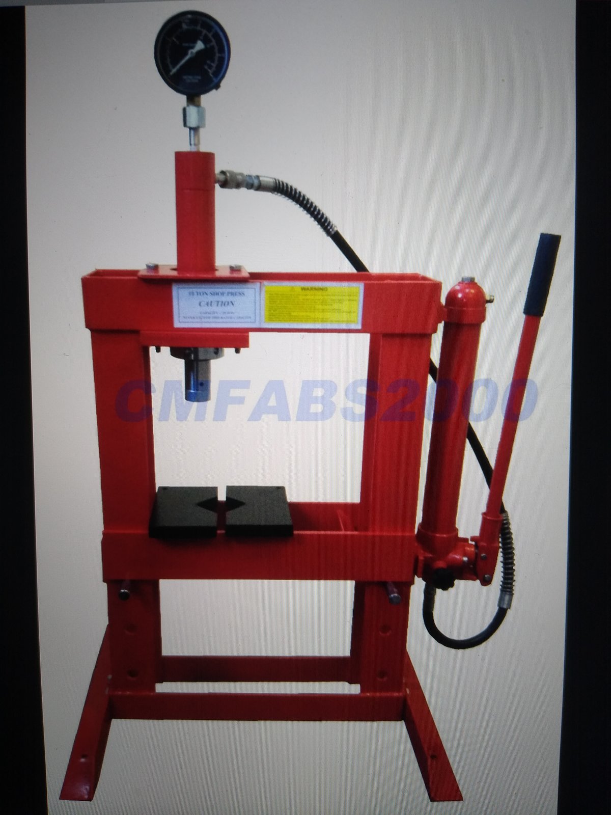

I just used 25mm black bar for my 25tonner.......and had it to the max loads'a times.....
it's only when u get down to 15mm dia u need the special steel.....
oh, my home made press has just about 2mm clearance between the bed and the frame legs.....

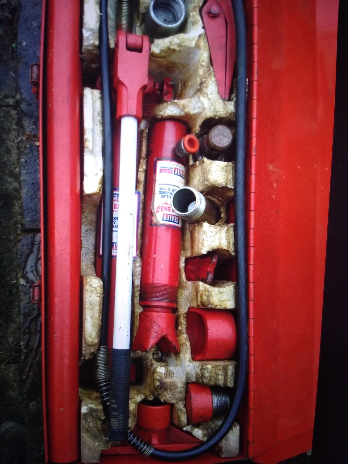

Anything really though given choice id use a grade with a higher tensile but with some springI picked up a 20 ton H frame today but it is missing the pins that support the bedplate. What grade of steel should I use for these ?
Thanks
I'll be putting some HDPE / PTFE pads, or perhaps some roller bearings to attempt to hold everything in position/alignment, and I've seen some cheap 20-ton air-hydraulic jacks on EvilBay, £55 so a bit tempting... Hoses, fittings and air valve will probably come to more
I'm thinking it shouldn't be too much more diffic' than turning a basic jack upside down to turn an air-hydraulic upside down, park it between the top crossmembers? The steel channel I'm assured should be good for way more than the jack can poke out!
Dave H. (the other one)
You can't just turn a jack upside down, it needs some internal mods. Loads of stuff on the web about doing it.
I made a press with a bottle jack when I was young and it served me well but proper rams with external pumps aren't expensive these days and the reality is you can buy a complete press with hand pump and ram for £140
