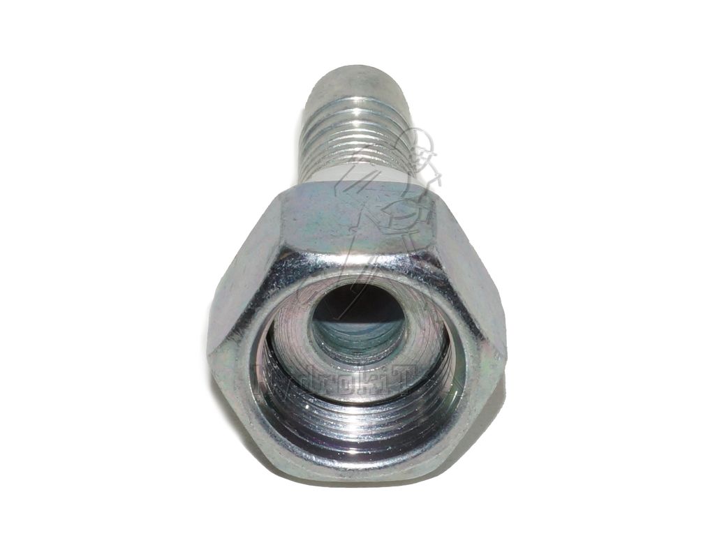

CRS51 Member Messages 268 Location Cheshire, England Mar 17, 2018 #1 Evening all, would this fitting be a " o ring face seal " type and from the dimensions what size or description would it be ? Thanks

8ob Member Messages 14,218 Location Nescient in the vale Mar 17, 2018 #2 Looks like a standard flat faced fitting, hiab use them and they have a ring seal. Bob
D Davidcardiff Member Messages 131 Location Kildare . Ireland Mar 18, 2018 #3 Yes it Looks like an ORFS fitting Are you sure the nut isnt 22mm It would be and 11/16 orfs if it is that size would be common on 3/8hose

CRS51 Member Messages 268 Location Cheshire, England Mar 19, 2018 #4 Davidcardiff said: Yes it Looks like an ORFS fitting Are you sure the nut isnt 22mm It would be and 11/16 orfs if it is that size would be common on 3/8hose Click to expand... Thanks for the help, cheers Chris
