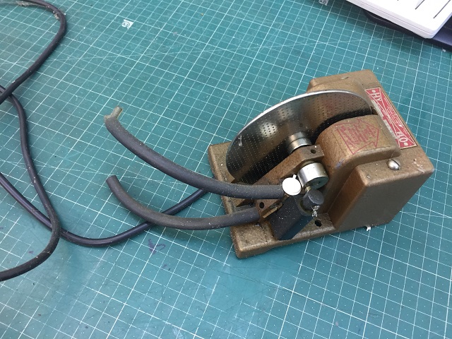

Anyone know about these?
This website makes them sound quite sought after but unfortunately, this one's broken;

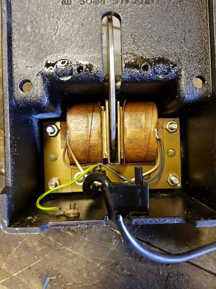

That's what's inside, just a pair of coils on a laminated core with the wheel between them. There's no continuity across one of the coils so no plugging it in does nothing. There's a few on eBay for £100 so it would be quite nice to sell it working.
Do we think it would be possible to repair/rewind the faulty coil? I haven't taken it out to dig any deeper yet

. Running a neodymium magnet past it has a lot of resistance so it's clearly very conductive, maybe it's plated copper
