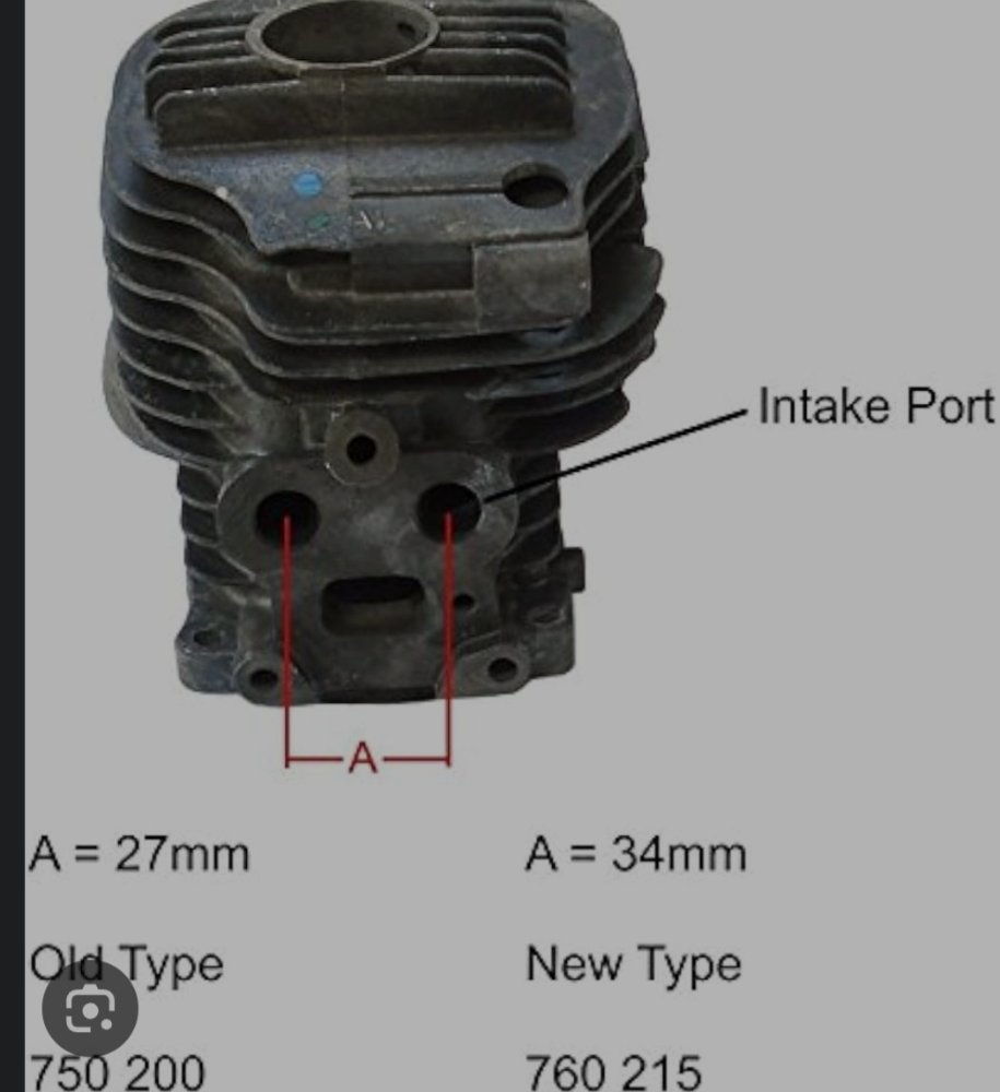

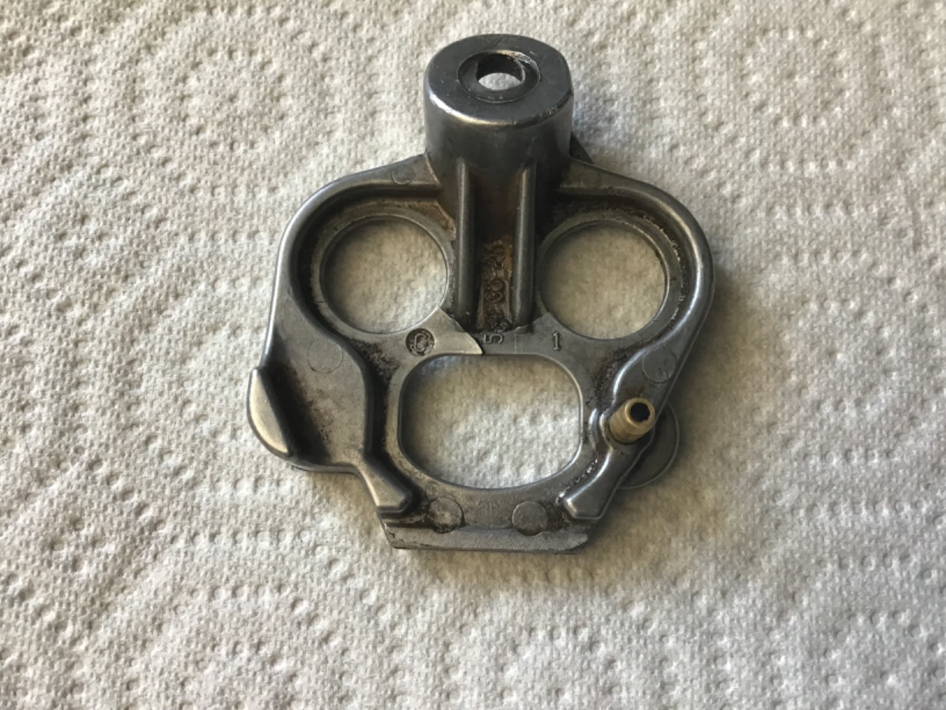

Can anyone tell me Please if this is the right part for the inlet flange on a husqvarna k760 pre 2013 as there are two parts one with part No 506266501 parts and one with part No 574231802 with wider style ports the one off the cutter has a fracture between the inlets so it does not sit flush. Would anyone know where I can buy one
