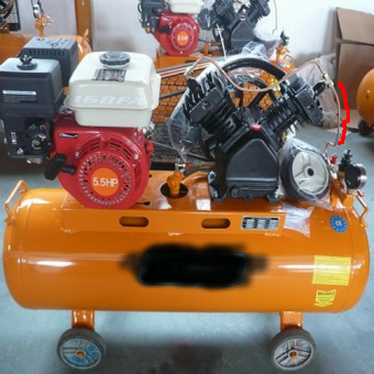

not the head pipe I doubt , the copper pipe can get to 100c to about 170c they do use over braid ptfe type hose on some, but the copper helps get rid of some heat in reality, before the tank to aid in stopping condensation forming.I notice a lot use a plastic type pipe,
