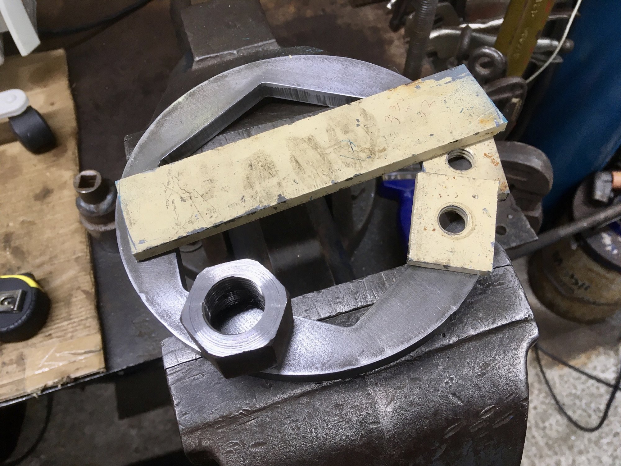

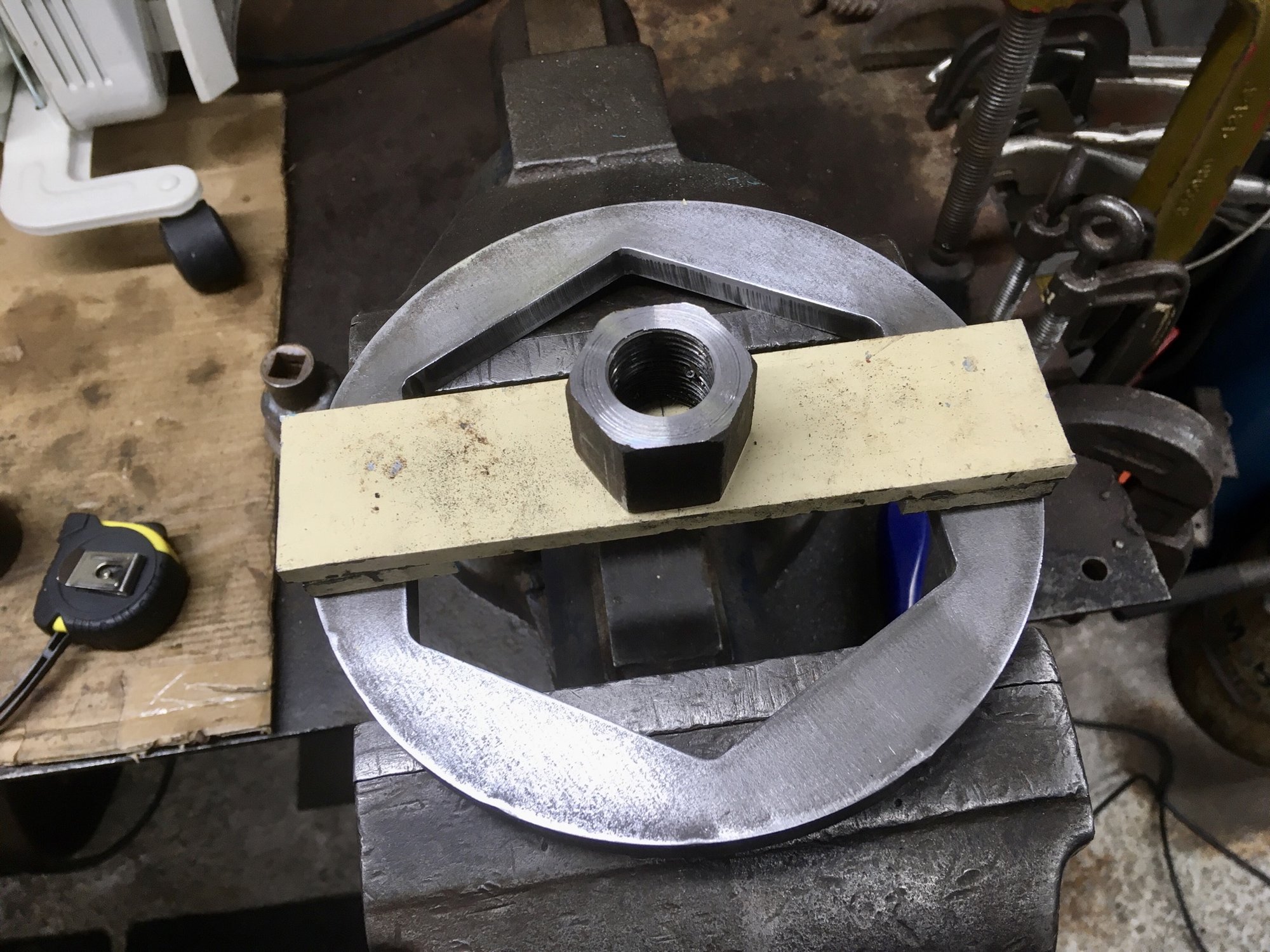

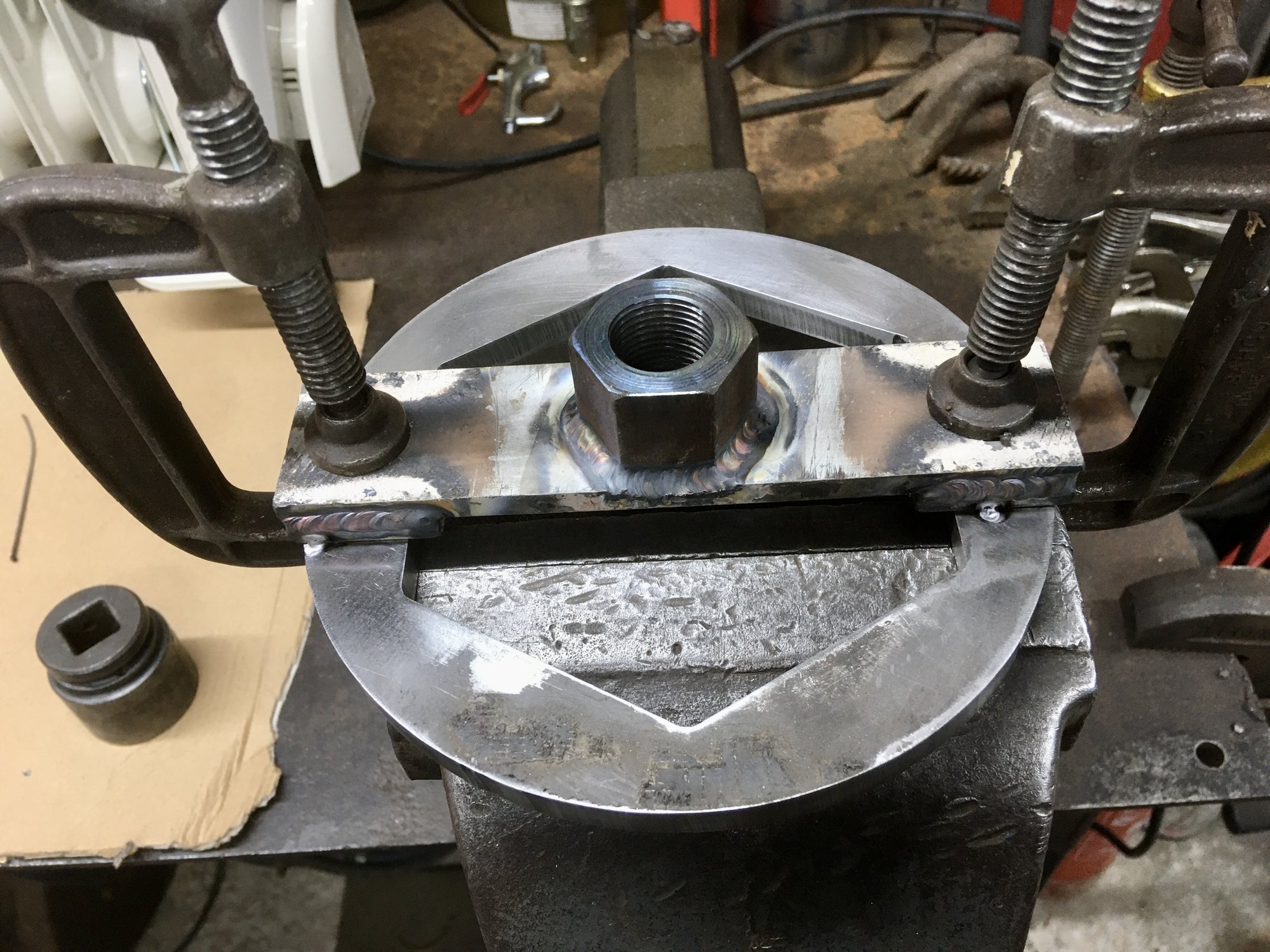

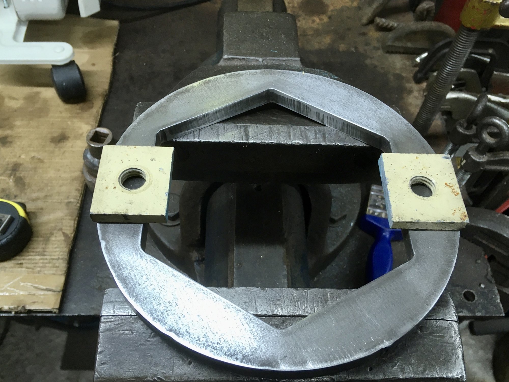

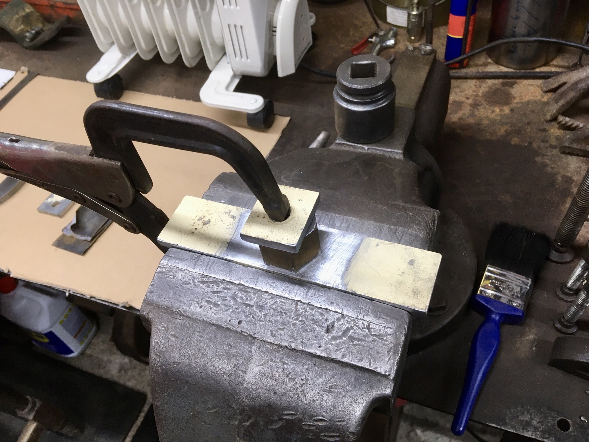

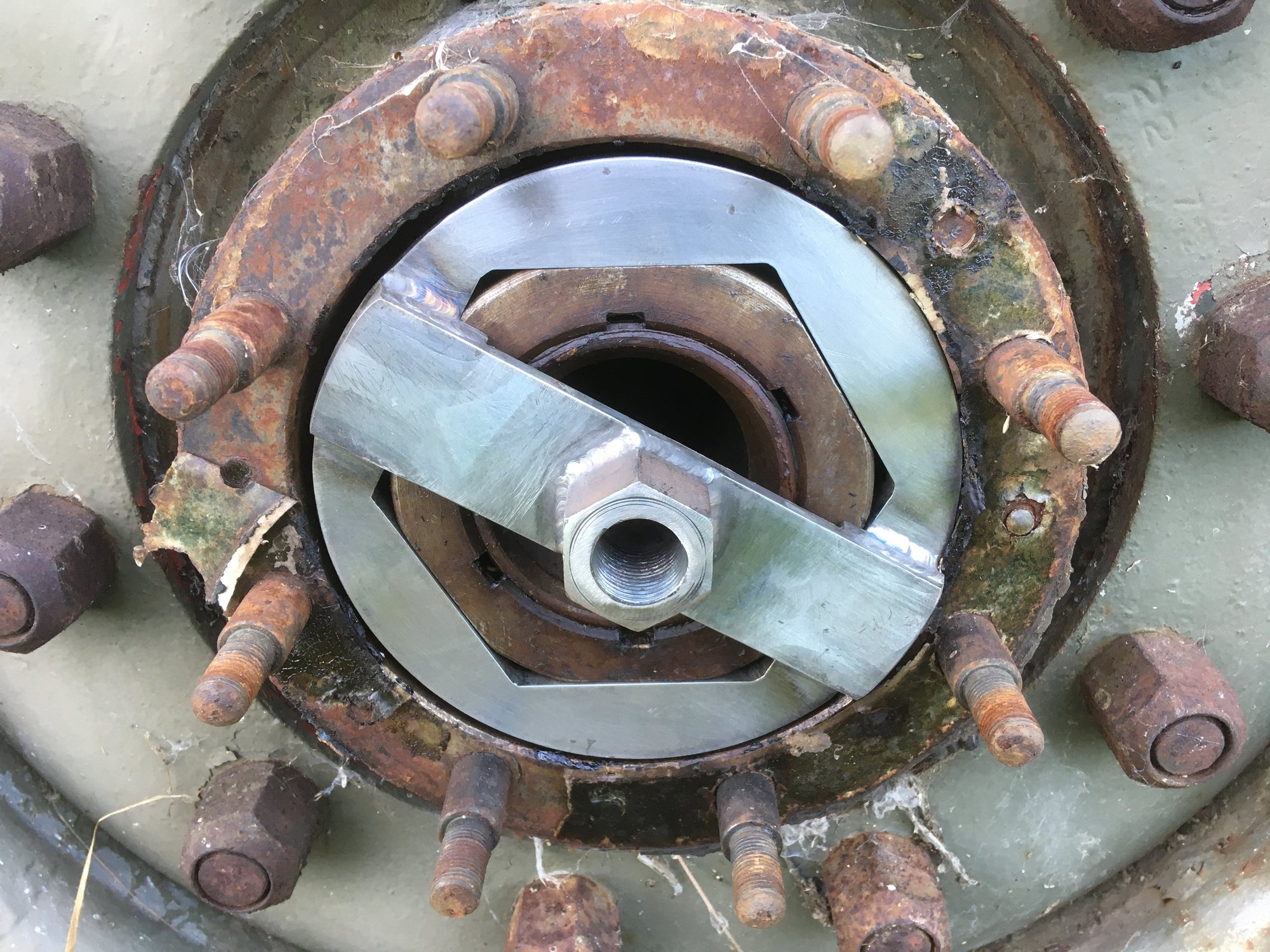

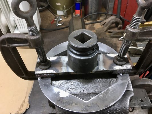

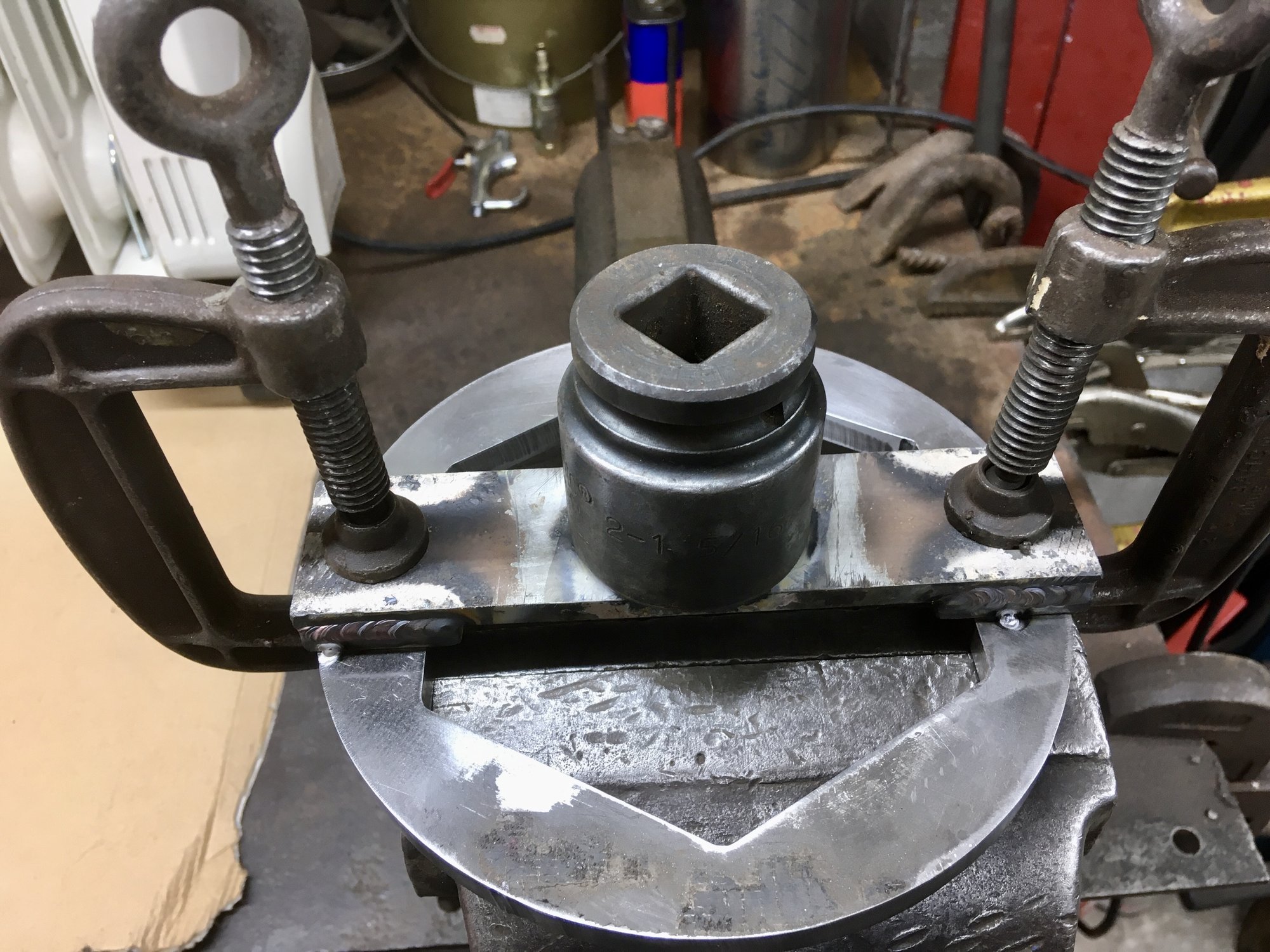

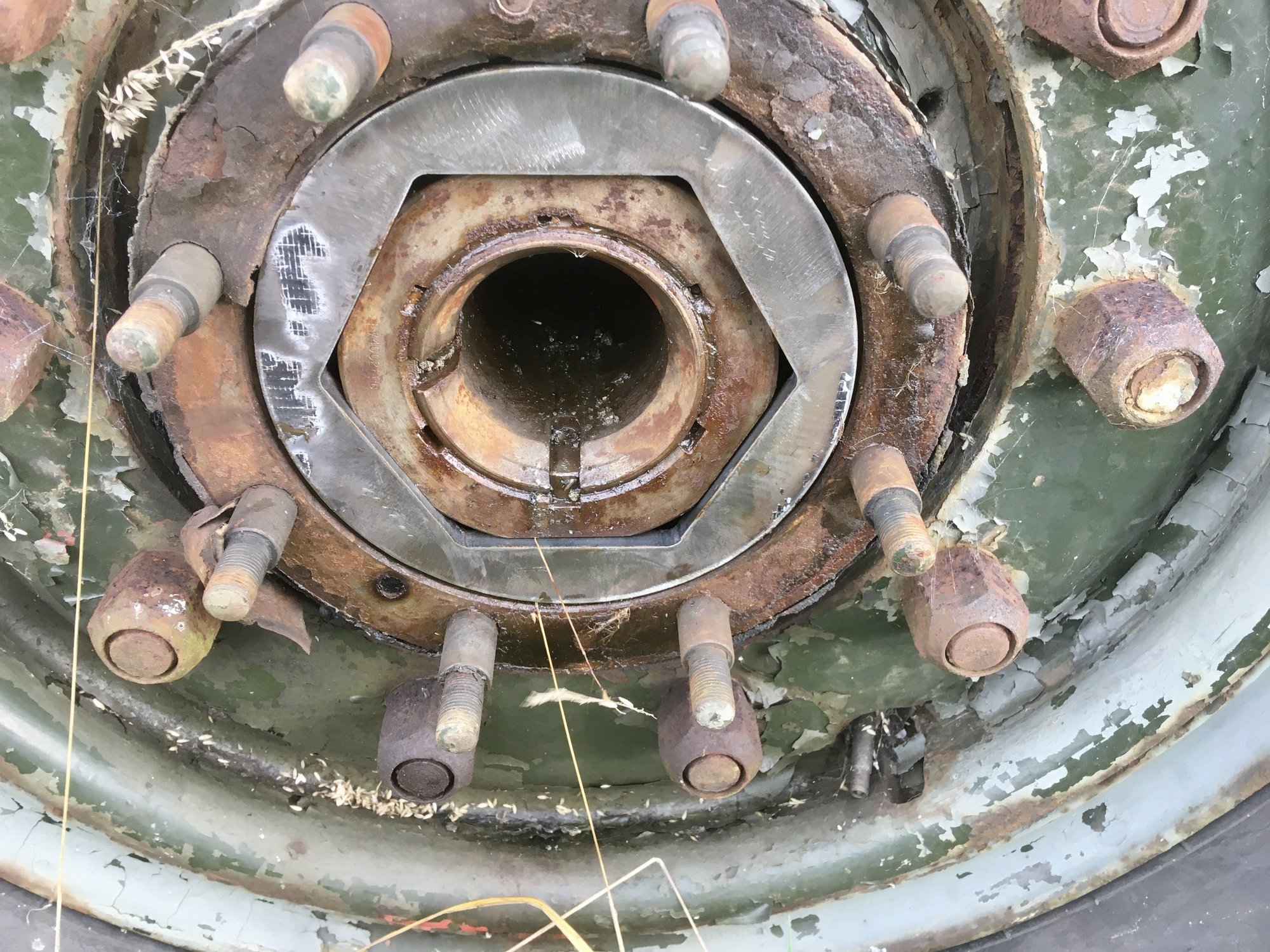

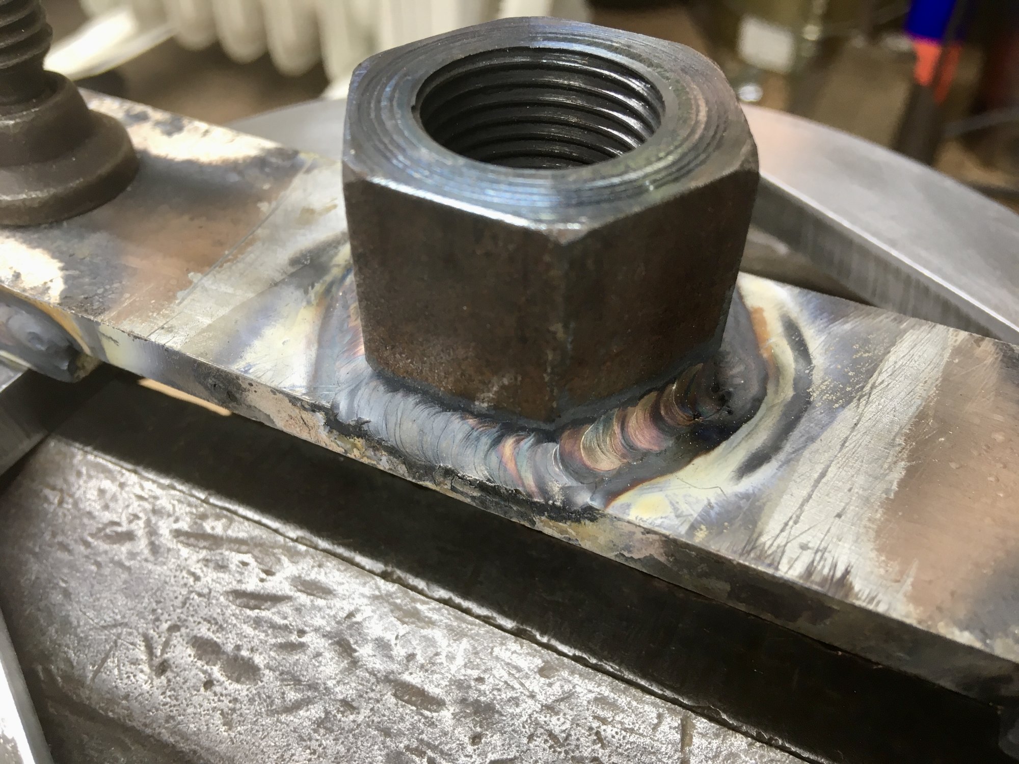

Many thanks to @doubleboost for cutting me a piece of steel to my dimensions. It is being used to make a hub nut socket for my 1958 Leyland Martian.
Hope the pics are ok
