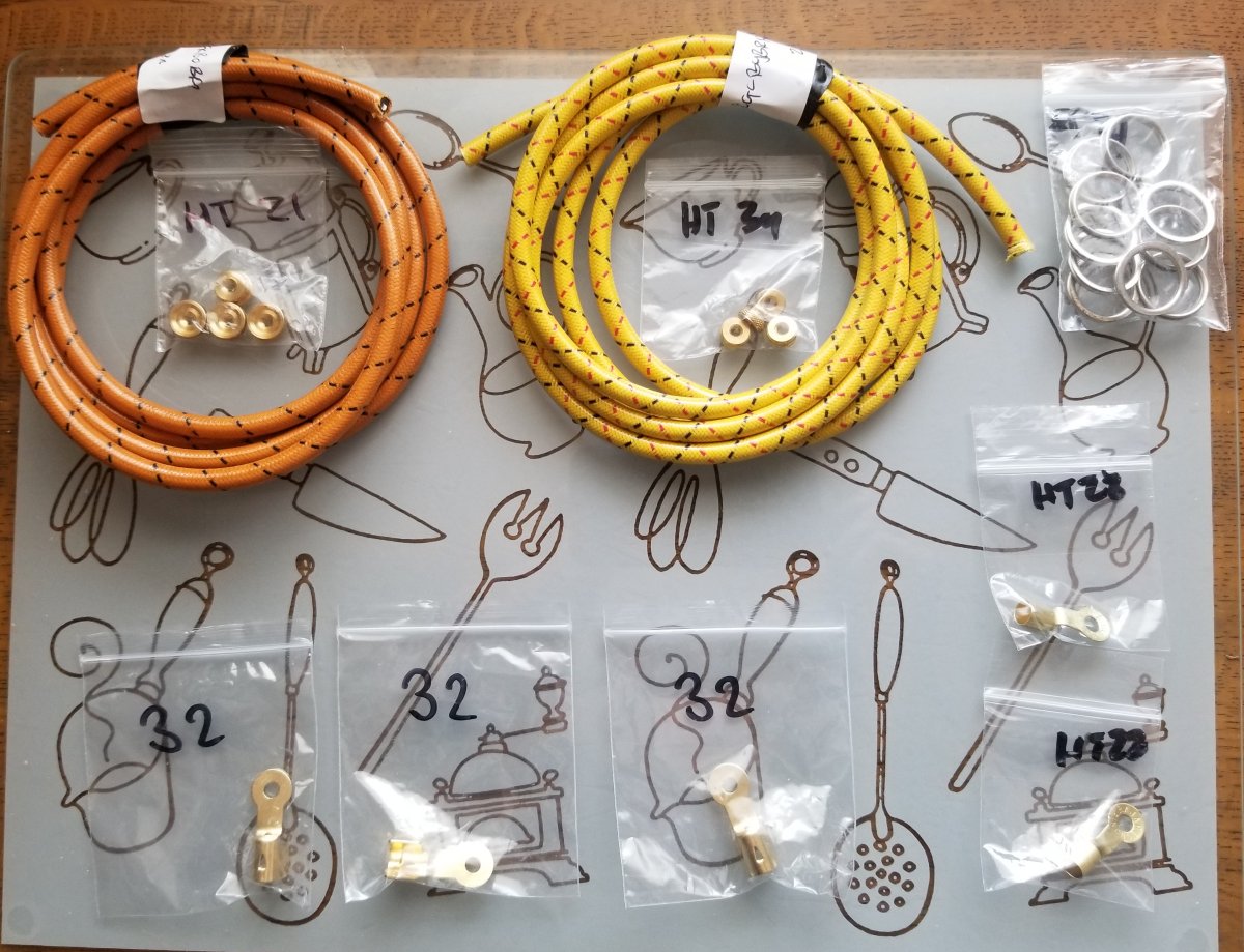

Vw Golf mk2? Didn’t take much to set off the buzzer on thema few years ago I used copper cored ignition leads and that was running parallel to oil pressure sender, it too me ages to work out that the copper ignition leads had induced a voltage in the oil pressure sender and was setting a high speed low oil pressure buzzer off. a change back to carbon cored leads solved the problem.
