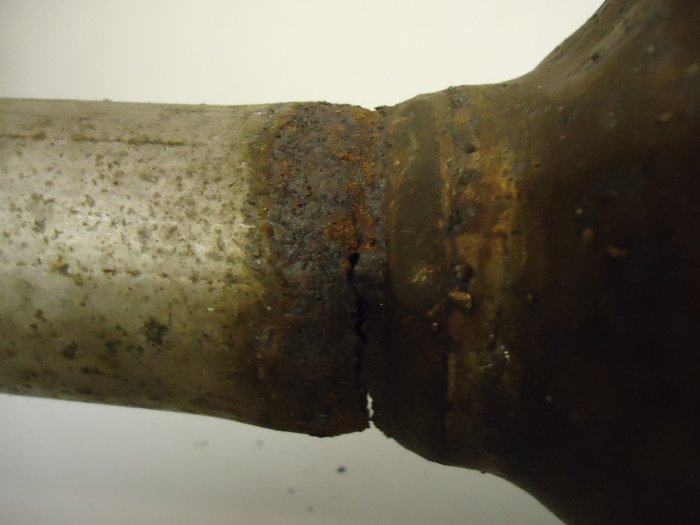

Hi guys,
I need to repair a break in a piece of exhaust pipe between the catalytic converter and the main exhaust. The stainless pipe has corroded through between the body of the catalytic converter and the main exhaust and left a gap!
A picture of a similar (but not as bad) disaster is here (2nd one down!)
http://forums.tdiclub.com/showthread.php?t=258836

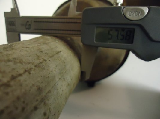

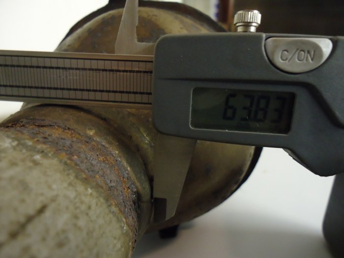

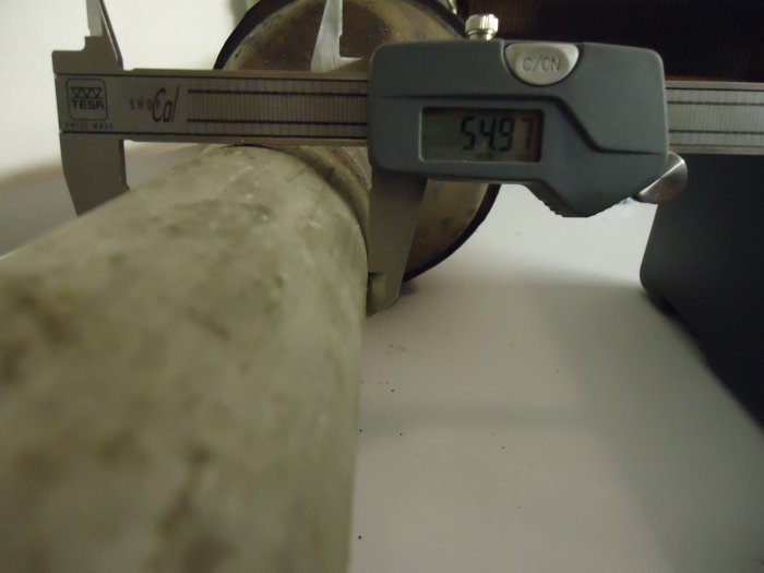

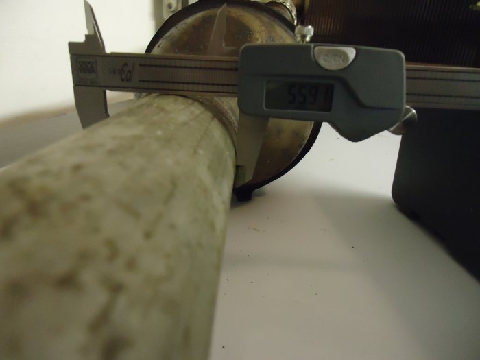

What I plan to do is to get some 2mm stainless sheet, bend it over some old exhaust pipe to make a tube... Weld this tube to the larger diameter of the outside of the catalytic converter itself (where it's a bit tapered), then tap it a bit so it tapers to the size of the smaller diameter pipe. Then weld it to the smaller diameter pipe, so I make a sleeve that completely covers the break.
I'm using TIG as a welding process..
Is this how you'd do it, or is there a much easier/better way?
Cheers,
David
