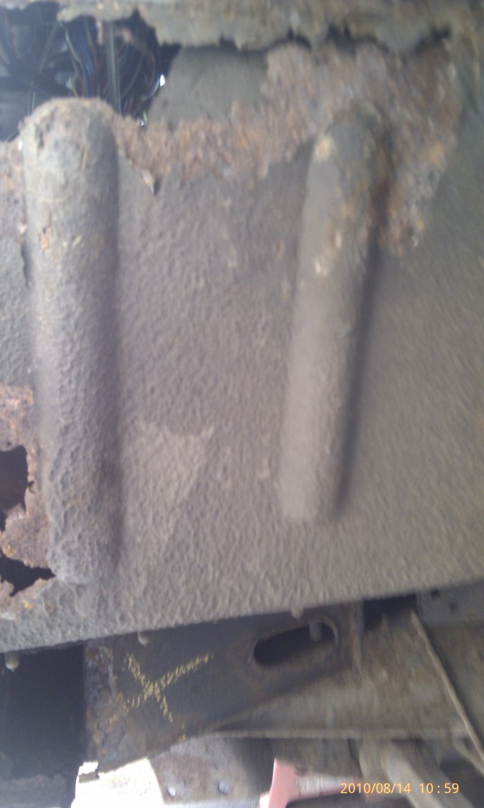

as said if your handy with woodwork hollow out a piece of hardwood to shape . then use a ball peen hammer to form the shape cheap and chearfull and a good jobmake a wooden last the correct shape in either positive or negative and then beat the metal to the correct shape. or buy a new panel.
either way you then need to clean the hole ensuring all the rust is gone and shape the new piece in and weld it up
