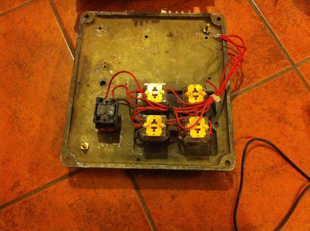

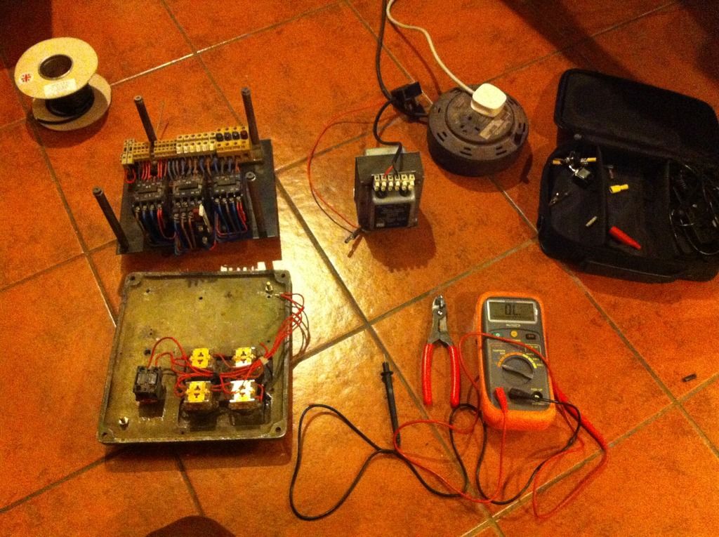

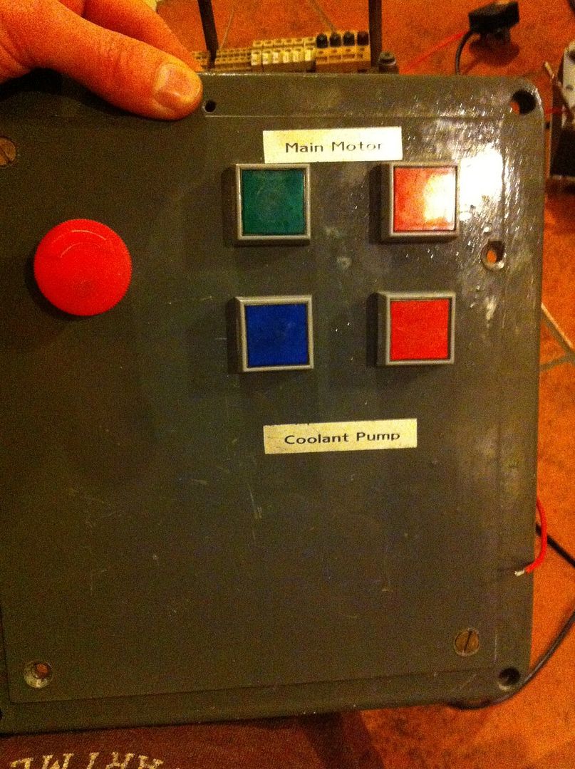

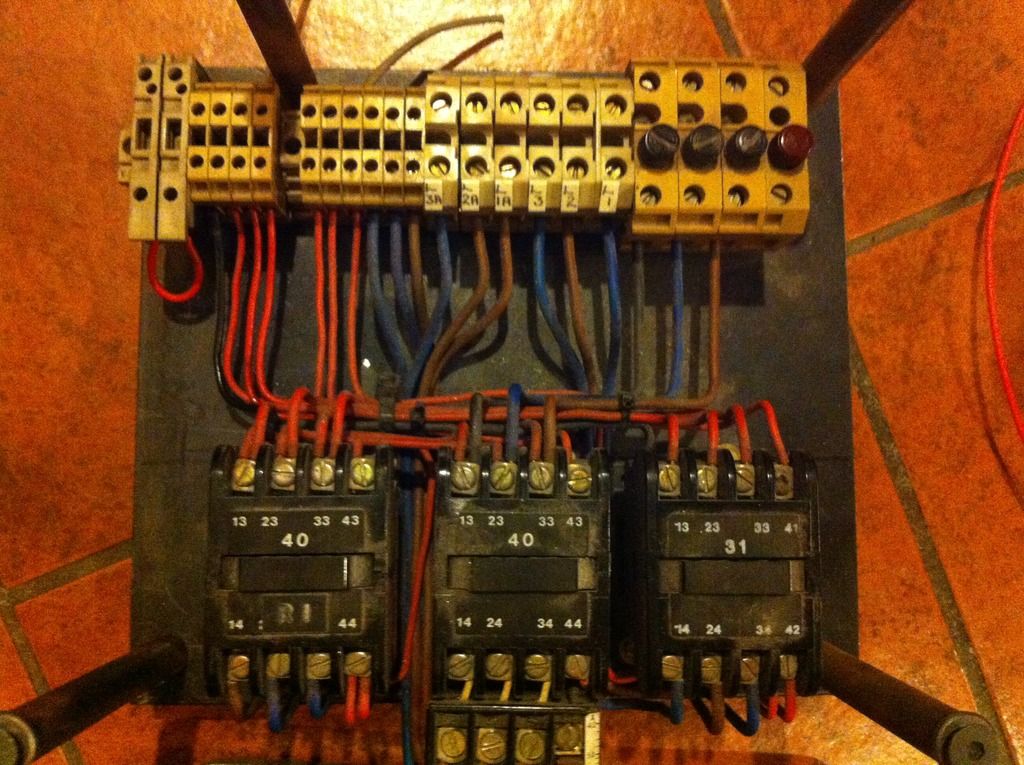

will you come over and fix it all for me please, ill give you all the tea you can drink, to be brutally honest your lucky im even using relays. this thing is a milling machine, it can kill you in so many ways its not even funny, hand in the wrong place and bang now you have no arm, almost everything in my place of work can kill me, the most dangerous are some of our customers. ive been around the place for over 25 years and still have all my digits, not been electrocuted,electrically the mill is one of the safest items thereOK, if it's your own, then it's up to you.
Any issues and you will only have your insurers to answer to.

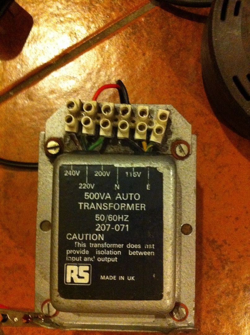

Your family might be concerned about the non-isolating scenario if things go wrong and it kills you though.
These things are designed and specified that way for a reason.
What is the EFLI at the machine incoming supply Vs the circuit OCPD?
Does this comply with BS7671?
Are you sure that the contactors you have will be OK by being supplied by an Auto Tx?
