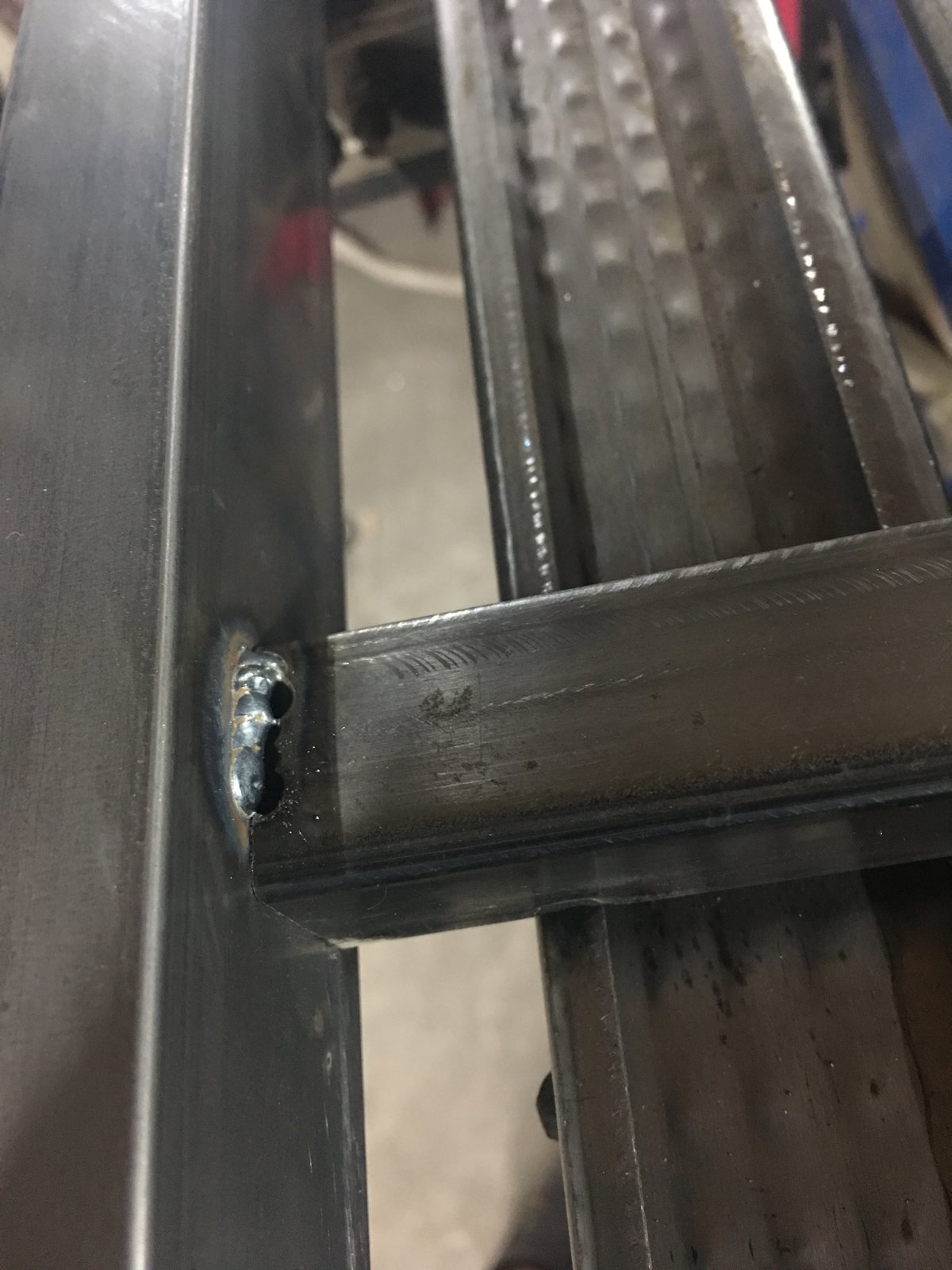

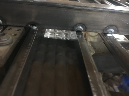

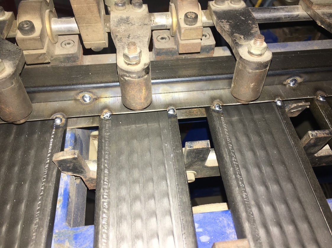

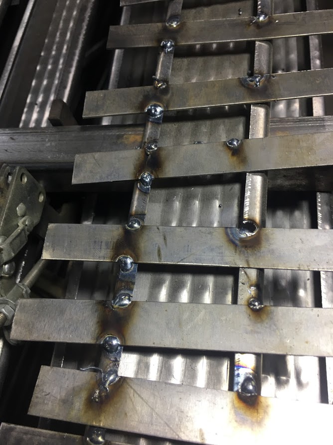

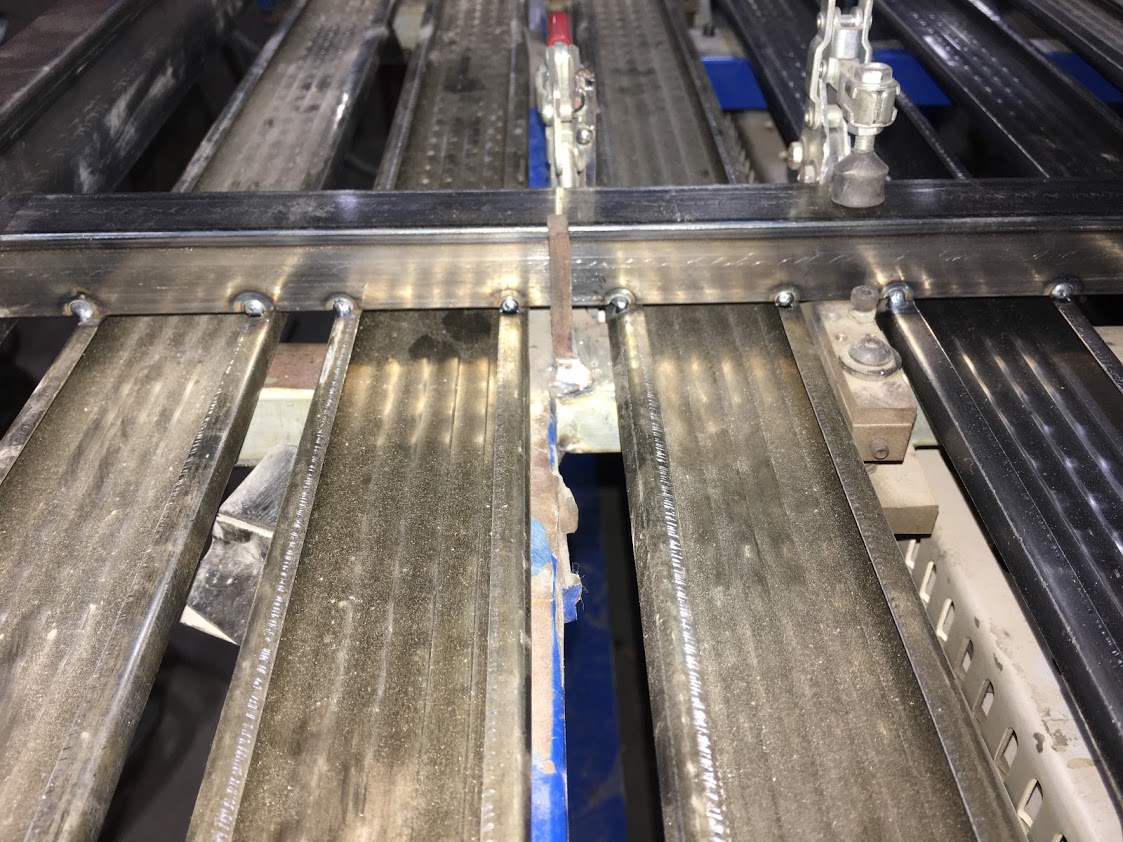

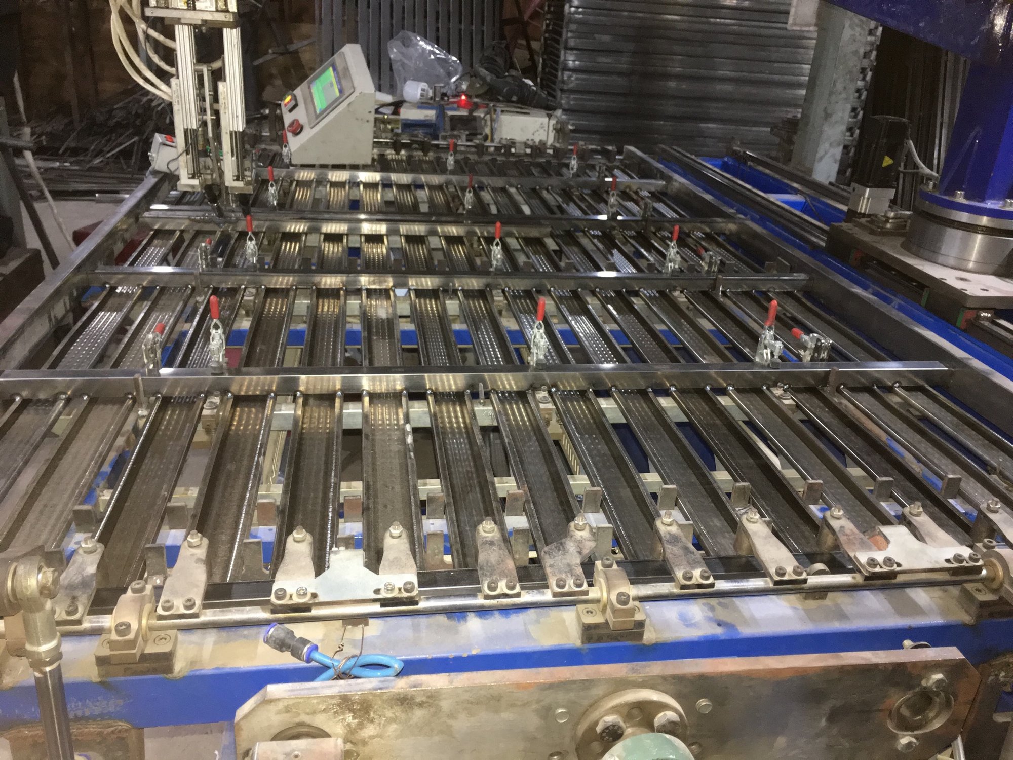

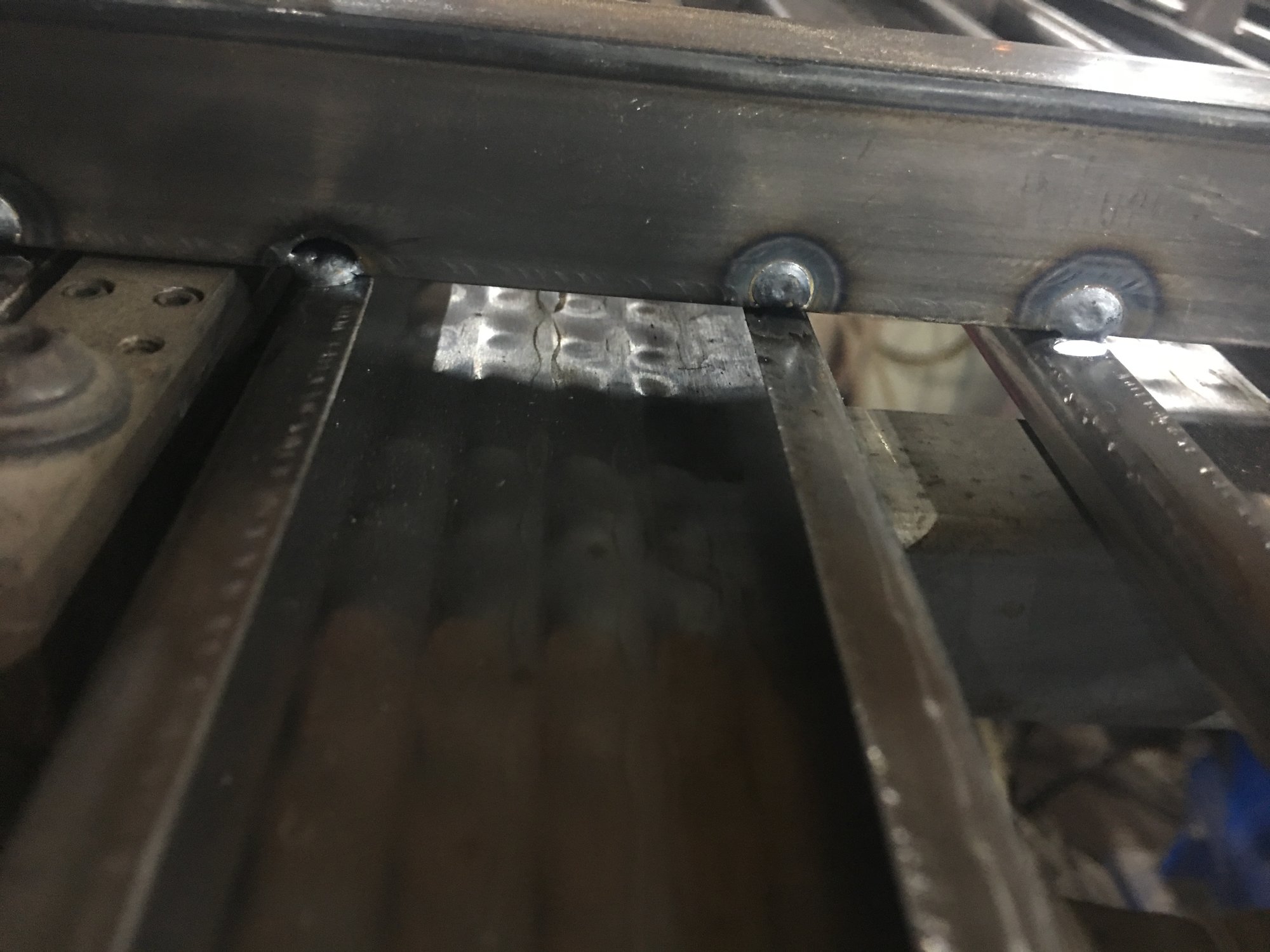

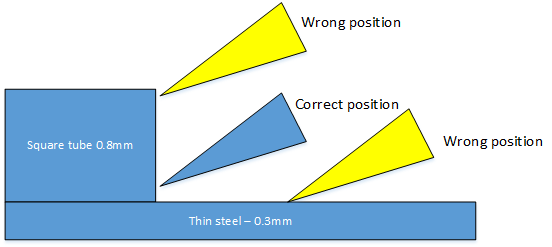

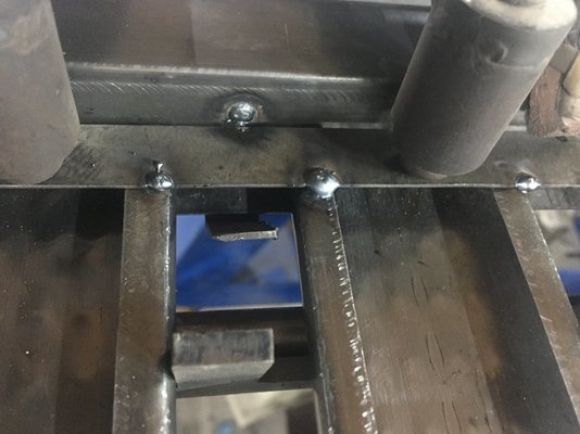

Hi All,
I use robot(i design for my self) to weld bed frame with thin iron stock. I use EDON MIG200 of China.
Problem: When I weld, it is easy to break, the stock is 0.4 - 0.8mm. So what is the configuration that I can setup, example speed, V, A, size's wire is 0.6mm or 0.8 mm ..Thanks all
