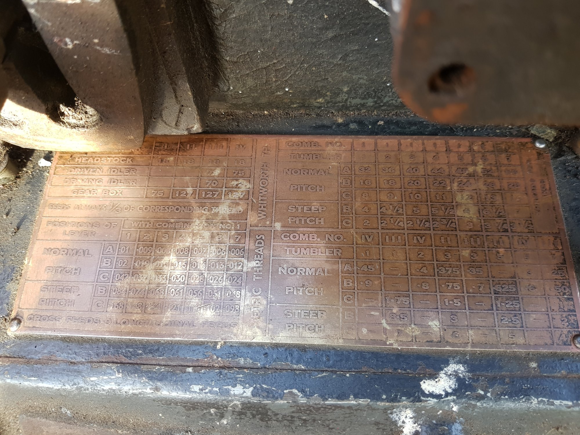

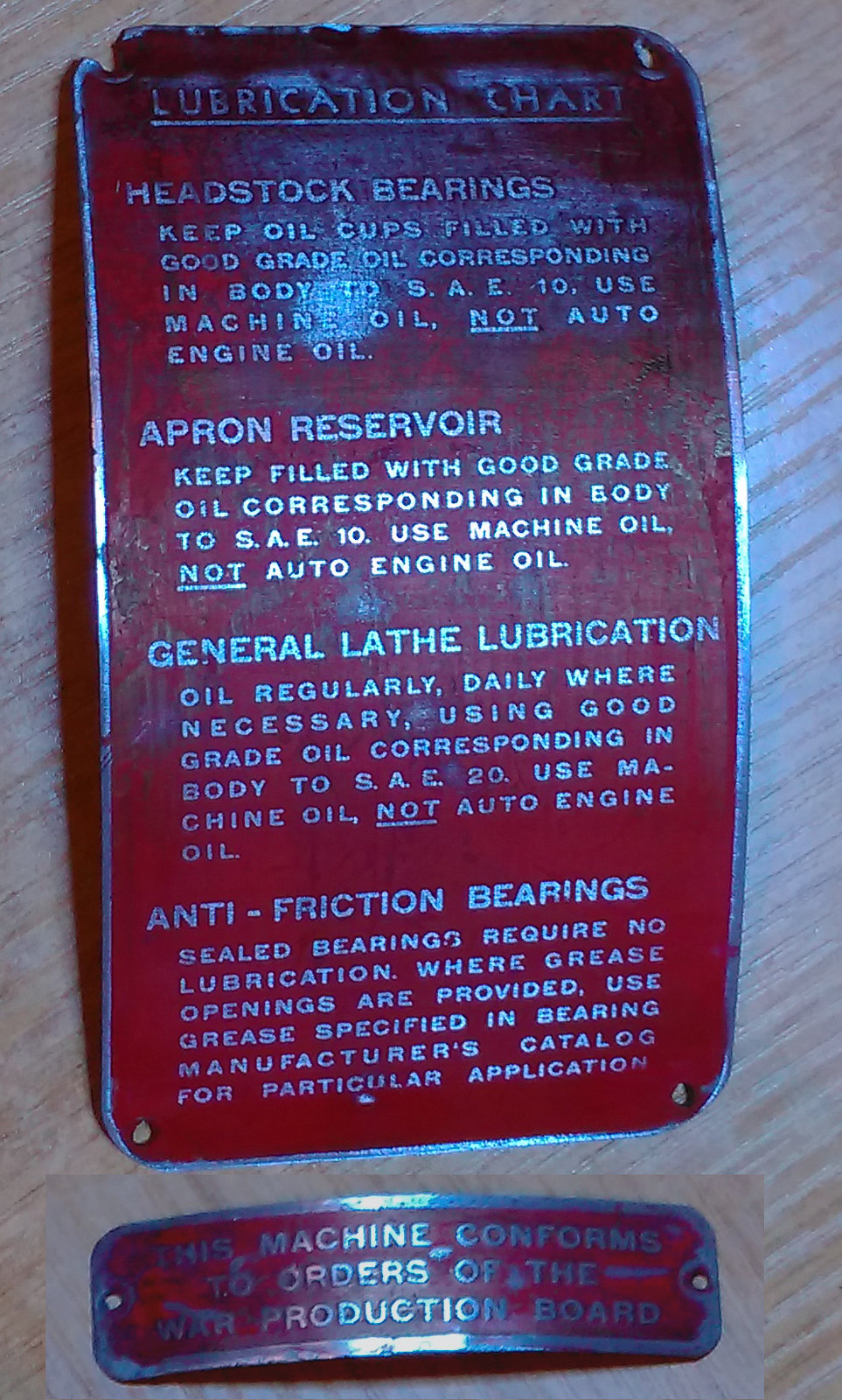

Is there anyone here who can reproduce machine plates like threading/lubrication charts? I suppose these were done by acid etching which I'm pretty sure I could do if only I could find a way of putting the acid-resistant mask onto the surface of the plate.
These particular ones appear to be either aluminium, or some kind of tin or zinc alloy. I'm not bothered about what base material is used but I'd like to be able to get or make new plates for my lathe resto.
Any ideas welcome.
