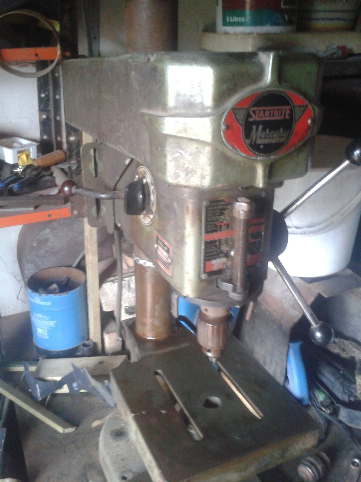

might have been beginners luck
cant even remember when I did it
sloppy git I am
