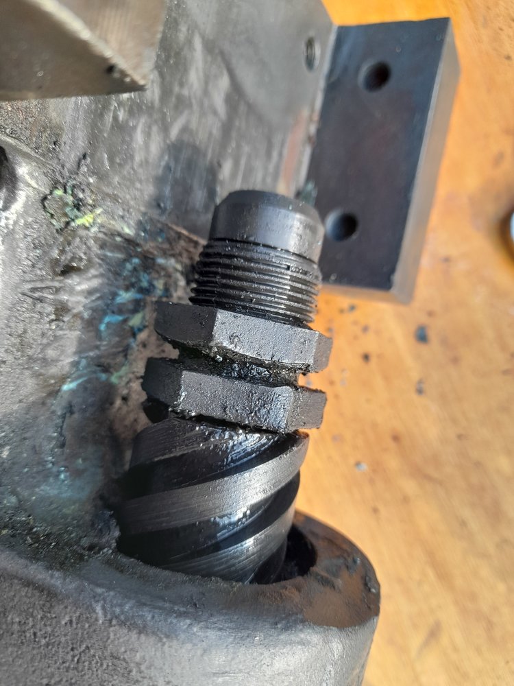

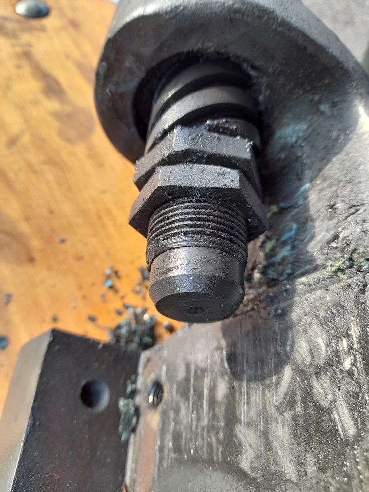

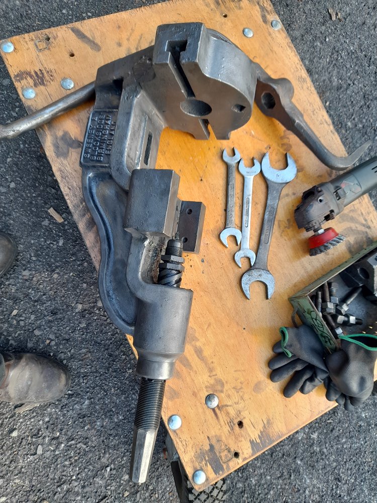

6 6ply Member Messages 2,729 Location Dorset, UK Mar 2, 2023 #1 I would have thought this would be straightforward, and I'm sure I'm missing something obvious, but how can I remove the main screw? To me it looks like those nuts need to come off but that part spins freely.

Screwdriver Forum Supporter Messages 11,052 Mar 2, 2023 #5 That caught me out with my first flypress. Looked at the nut and thought, damn, it's broken...
6 6ply Member Messages 2,729 Location Dorset, UK Mar 2, 2023 #6 Screwdriver said: That caught me out with my first flypress. Looked at the nut and thought, damn, it's broken... Click to expand... Yep!
