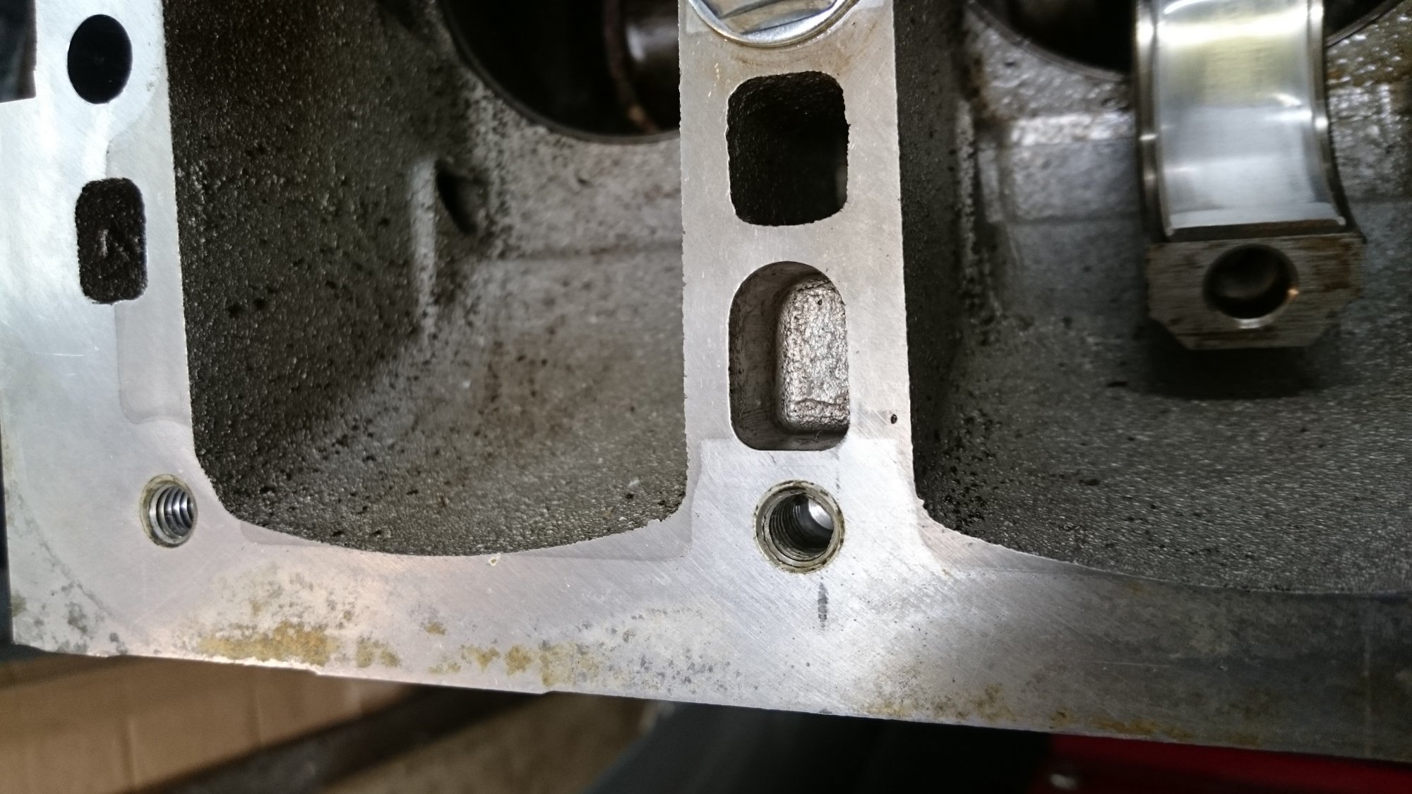

Either a copper coin
Thanks for all the suggestions. I have been waiting for the loctite 7200 to arrive which it did on saturday, unfortunately it didn't work and neither did the brake cleaner
Alcohol was no use either as this was anaerobic sealant not silicone/rtv
Matt's suggestion worked perfectly with a two pence piece held almost flat and just using the raised edge lightly the sealant came off without any scratching, thank you!
