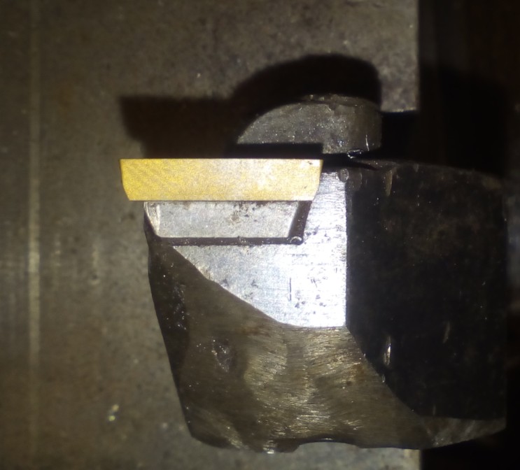

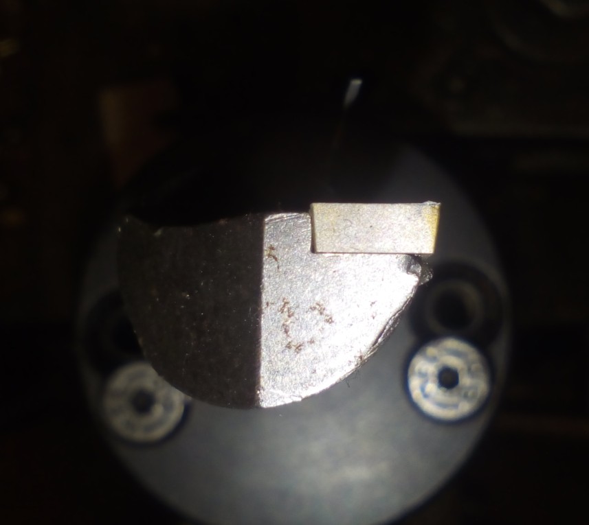

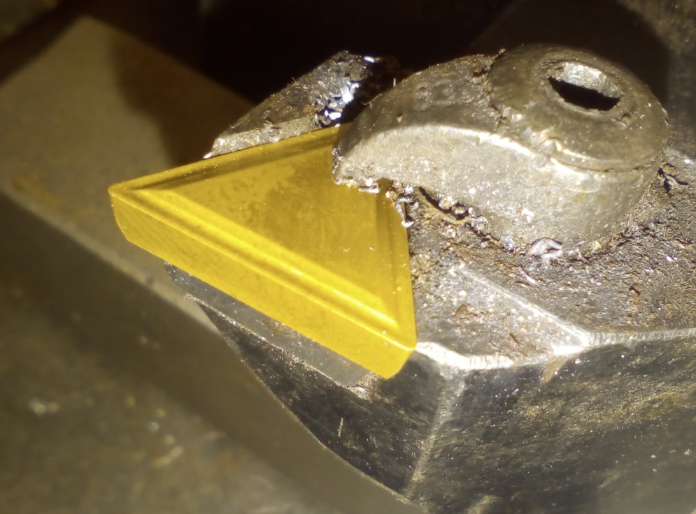

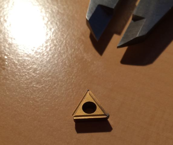

It's a bit late, but to me that looks like a TCMT 10 02 04. It might be a TNMG - N denotes a 0° relief angle whereas C is 7°, and G is a plain fixing hole whereas T is countersunk.Although I only have the one damaged tip I would still like to know how to identify it when searching for replacements.
It is showing 10.03mm from point to point with a thickness of 2.54mm, looking on ebay there are just numerous numerical codes which mean nothing to me.

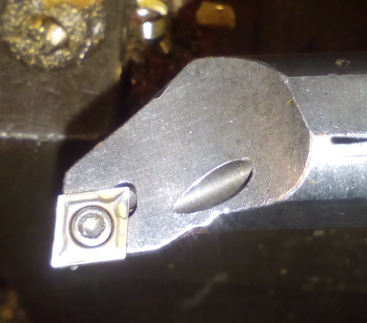

@addjunkie I never got an alert to this kind offer, many apologies for the late reply and pm incoming.I thought the TCMT 11 quoted by hood sounded familiar. I had a rake today and found some that fit my boring bars. If you @cumbriasteve PM me your address Ill pop one in the post for you to confirm the size
