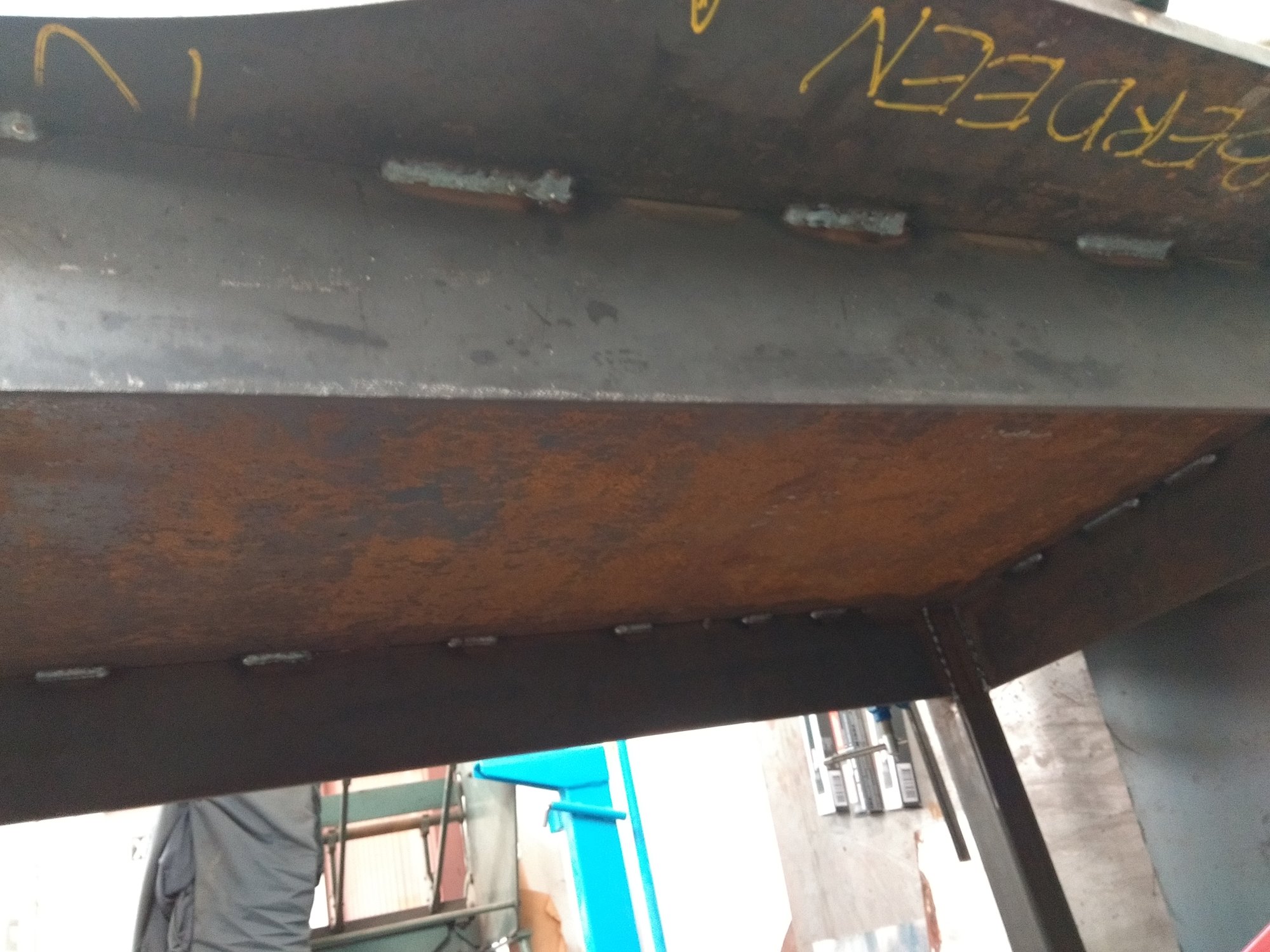

Morning all,
I'm finally making progress on the frame for my new workbench. The top is 20mm thick, approx 1m x 2m.
How would you fix the top down? Options I've thought of;
- Weld it. At the moment it's pretty flat so I'm reluctant to put too much heat in to it. My welder's only 215A so they would be tacks really.
- Drill and countersink/counterbore for flush fixing. The hex socket holes would probably fill up with rubbish.
- Drill and tap and fit studs. A bit more faff, but would avoid holes in the top.
