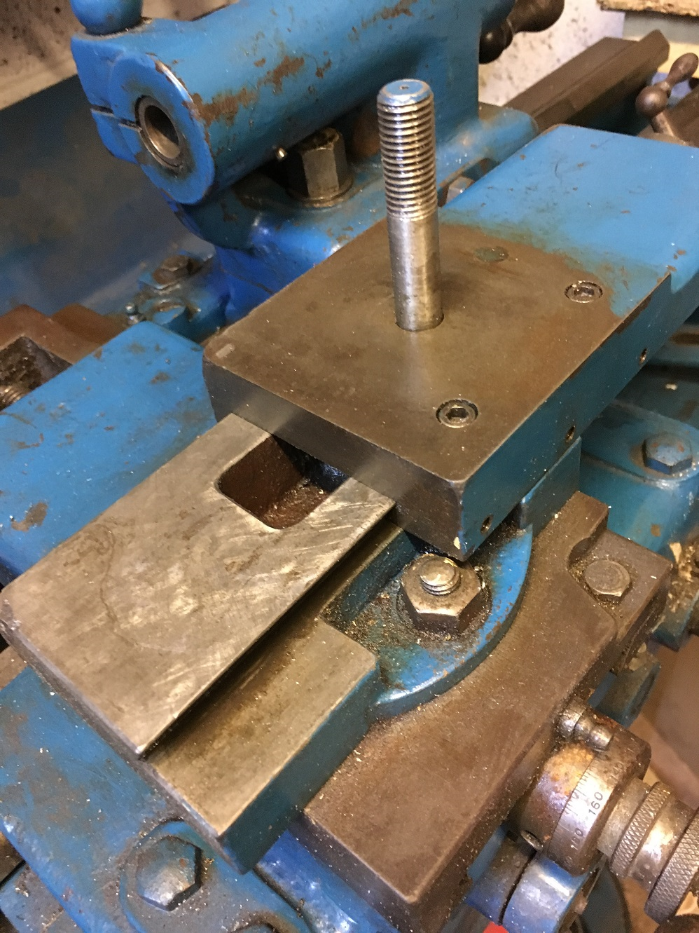

I'm keen to fit a quick change tool post, like this one from Phase II, to my 1940s Denham lathe;

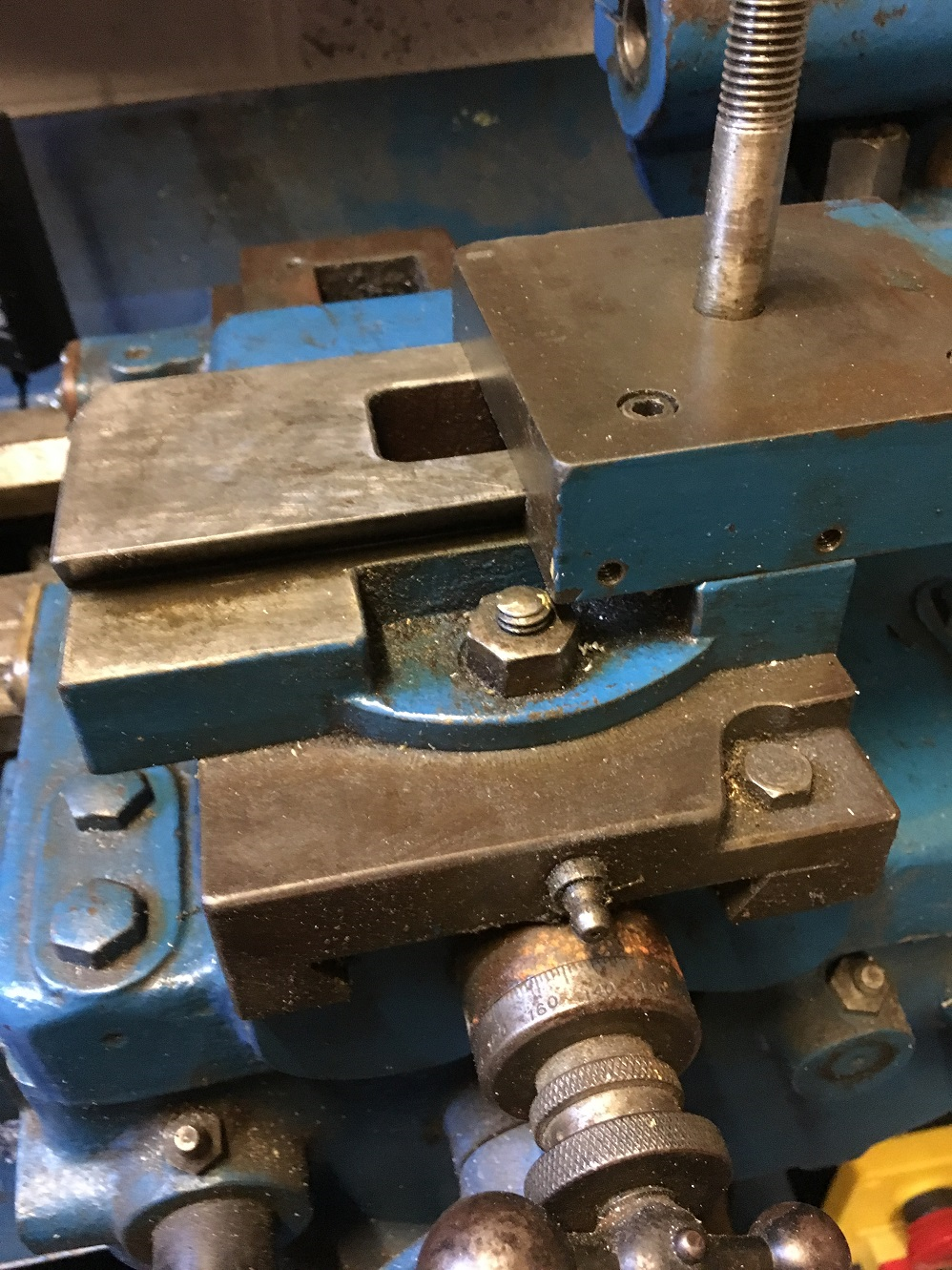

Problem is that it expects to be mounted to a carriage that has a T slot, yet mine looks like this;
Here's a quick vid of all of the component parts on my lathe;

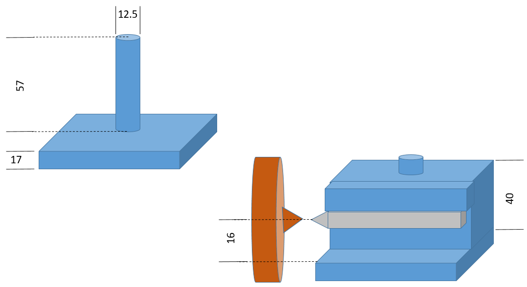

I'm assuming, also, that it's critical where the QCTP fits vertically in terms of having any chance of the tool hitting dead centre, so I'd presume that the QCTP needs to sit here;
Machining a T slot in there seems like quite a scary (and one-way!) proposition
Any thoughts? Or am I wasting my money (the lathe only cost me £180 and I suspect the QCTP, with $$$-to-£££ conversion) will cost me the same again...
