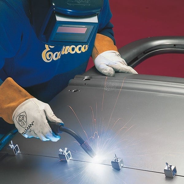

Self tappers,fill holes afterwardsFirstly, joggling (if using a hand tool) does not go well on compound curves - if the panel is relatively flat you might get away with it, secondly the panel needs to be clamped in place without distorting - that might be difficult if the repair is in the centre of a roof.
