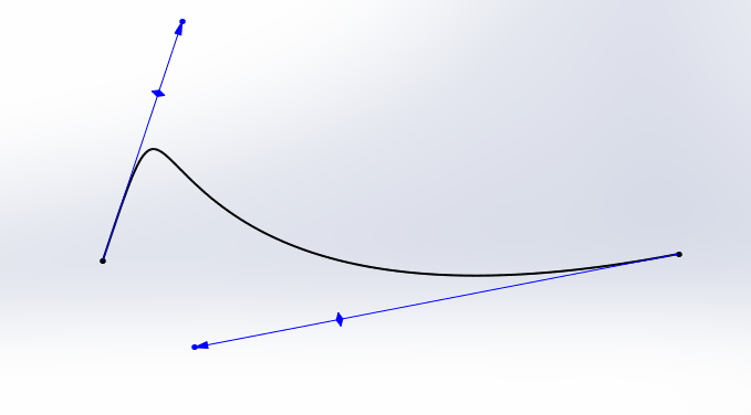

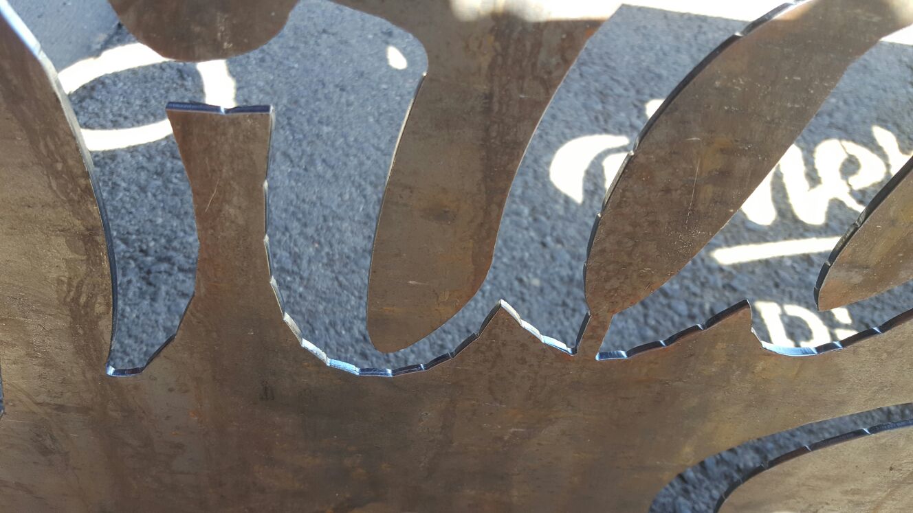

Hi, I am doing some designs using corel or solid works to put them into my cutting software. The problem is when I have drawn using spline lines ( like a rounded curve using vectors to choose with detail each rounded form to every cm of the line, like if I draw a letter "S" ). When I have drawn it and saved it in .DXF, when I put it into de cutting software I can se small united lines in every curve, so it isn't a regular curve, and when I put at the machine to cut it, it cuttes like small bites which mkes that the cut is not polished.
Should I use another tool to draw? or there is a tool to convert these lines into other tipe?
