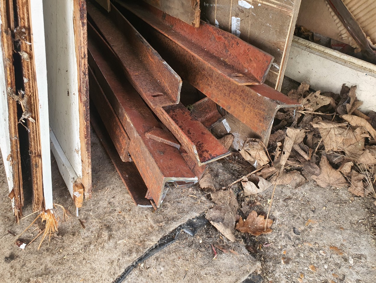

I have a bunch of angled steel 45 x 3mm to make the tower.

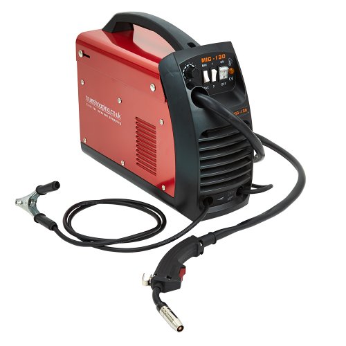

So the first question is, what is the best type of welder to use for this? I already have a basic wire fed 130Amp MIG welder (see attached photo),
But it needs repair and I haven't done many good welds with it. So I'll either learn to weld properly with it or invest in a new machine say an ARC welder or whatever you suggest and learn that.

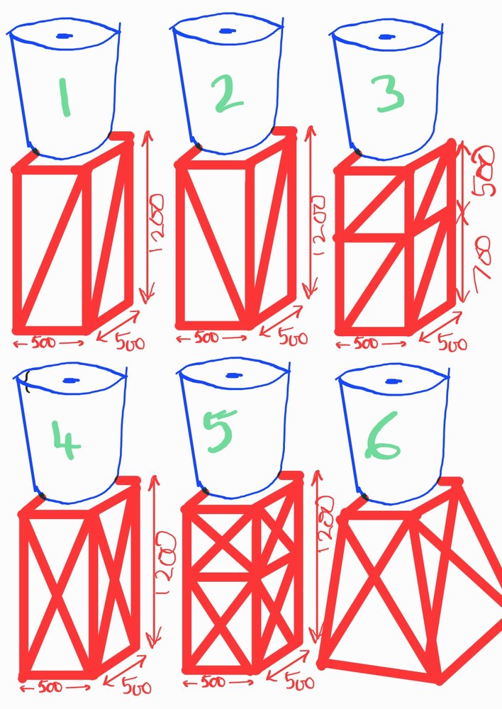

Second question is how to design the strongest frame. Obviously 45 degrees braces seem strongest but can't figure out how best to arrange it. Do I do 1 brace at 45, or criss cross braces? Do I just weld one rectangle with a >45 degree brace, or a 45 degree braced square plus a smaller rectangle? Tapered or straight column?
I've done a few sketches to show what I mean
