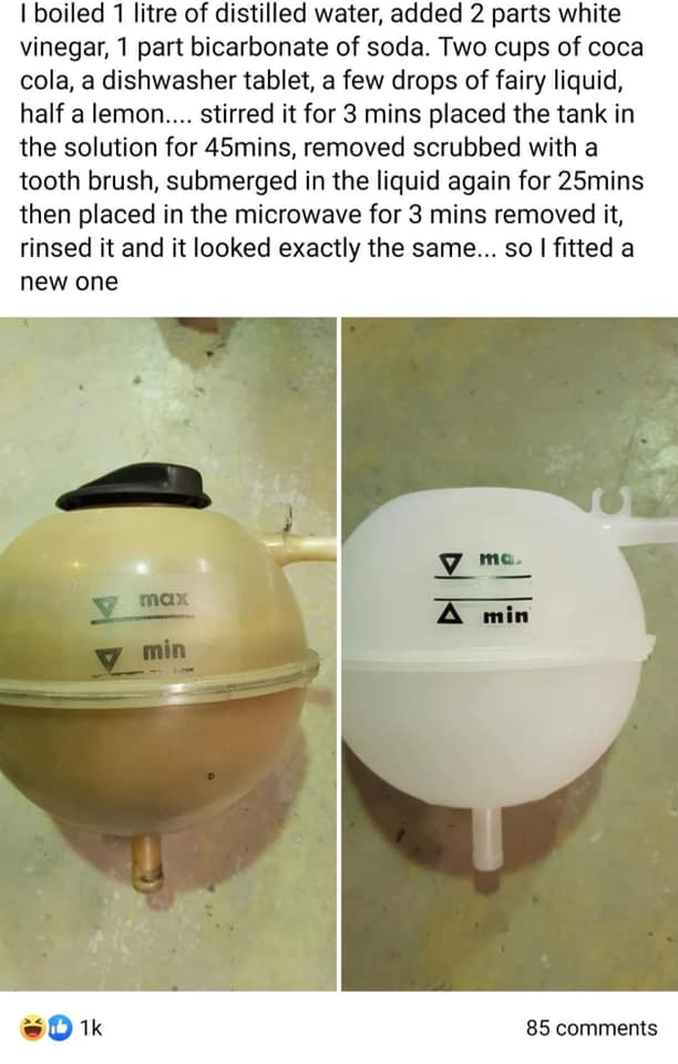

I have just purchased another pick up the rad and expansion bottle is full of K seal looks like a dry beach that had a oil tanker crash on to it in the expansion bottle. The thing is still blowing bubbles in the rad when reved so the K seal didnt work! so the plan is to flush the system probably throw a dishwasher tablet or 2 in the rd and let it work for a hour or two. then flush the cooing system with the hose. Then strip it head off oil and coolant out flush some more. New head new water pump and see what we got i know this K seal can be a bugger to get rid of. does any one have any other tips or better ideas?
unless you have other problems that are causing it to coagulate in the wrong places...
