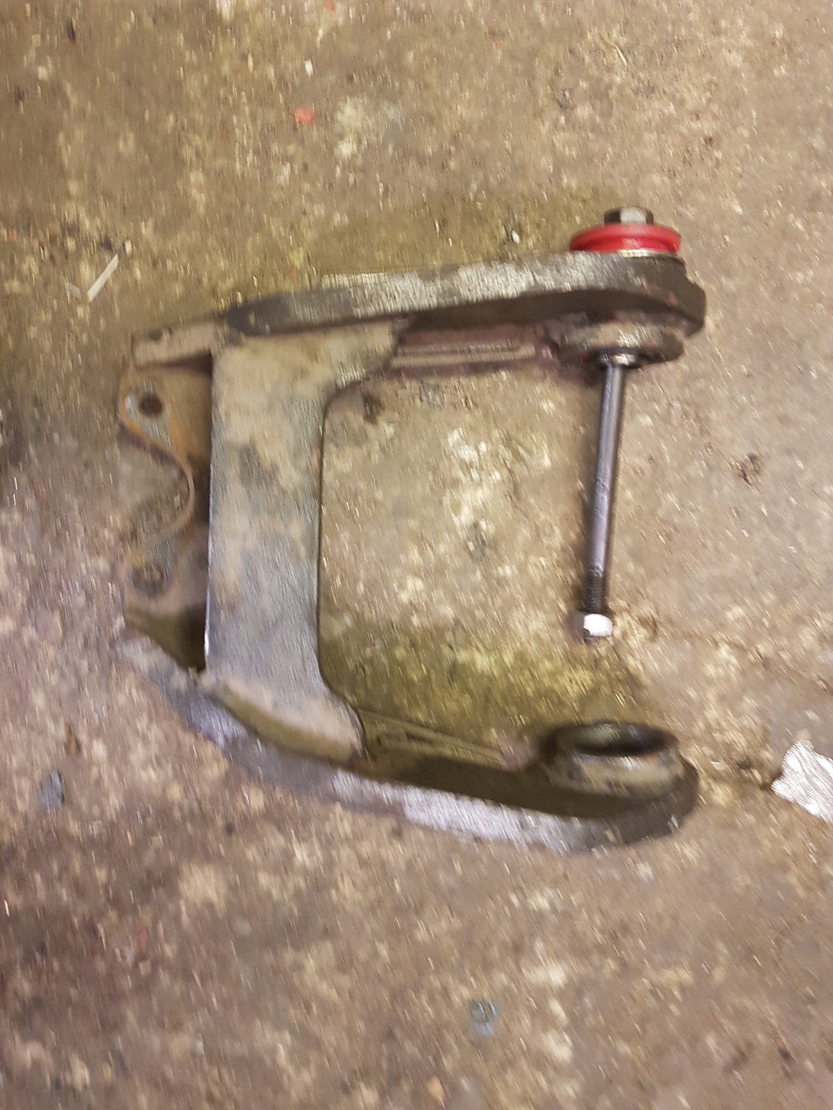

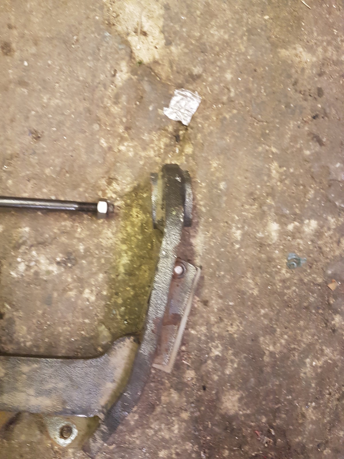

ok so what is the best way to straighten this?
the bush install tool bent it when winding the new bush in
DOH
DOH
a big vice and heat with oxyacetylene torch
i was thinking that but it might bend the wrong side!Use the toot that bent it to straighten it?
it did have 1/2" windy gun on the end of the puller!It bent without heat it should straighten the same. Hold it in the vice and get a big Stilson on it or use a hammer to beat it straight.
