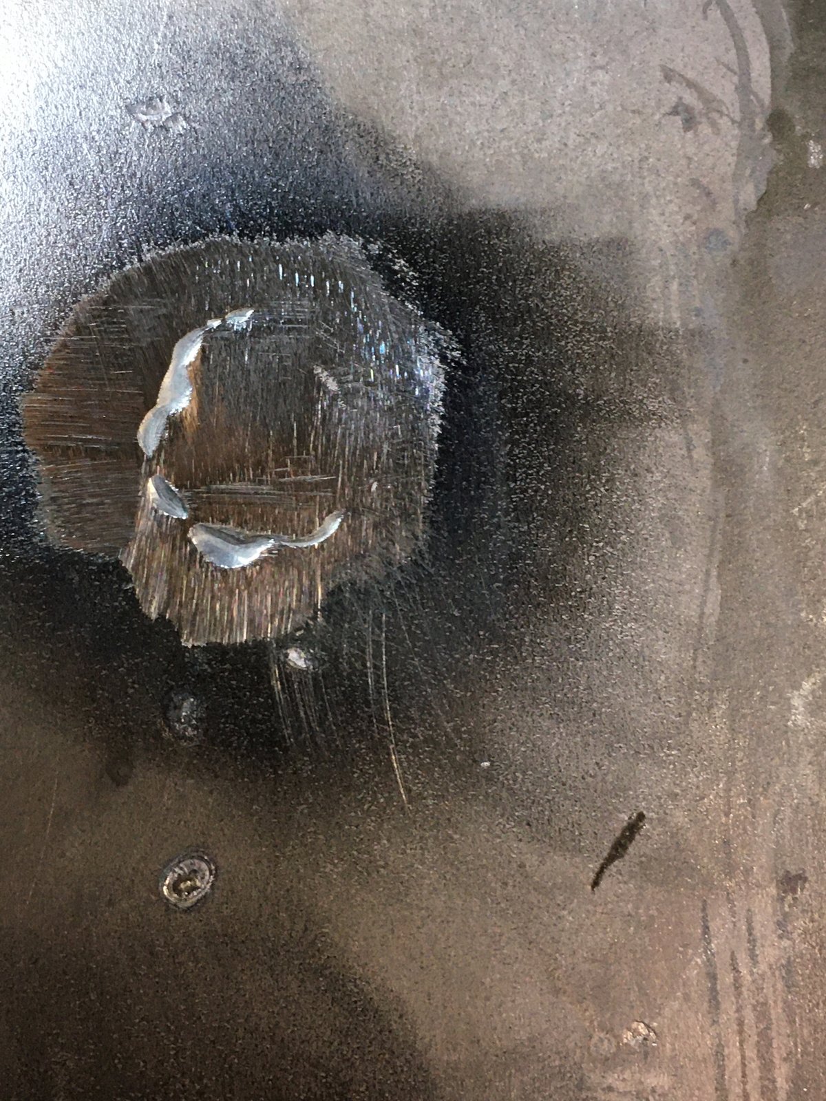

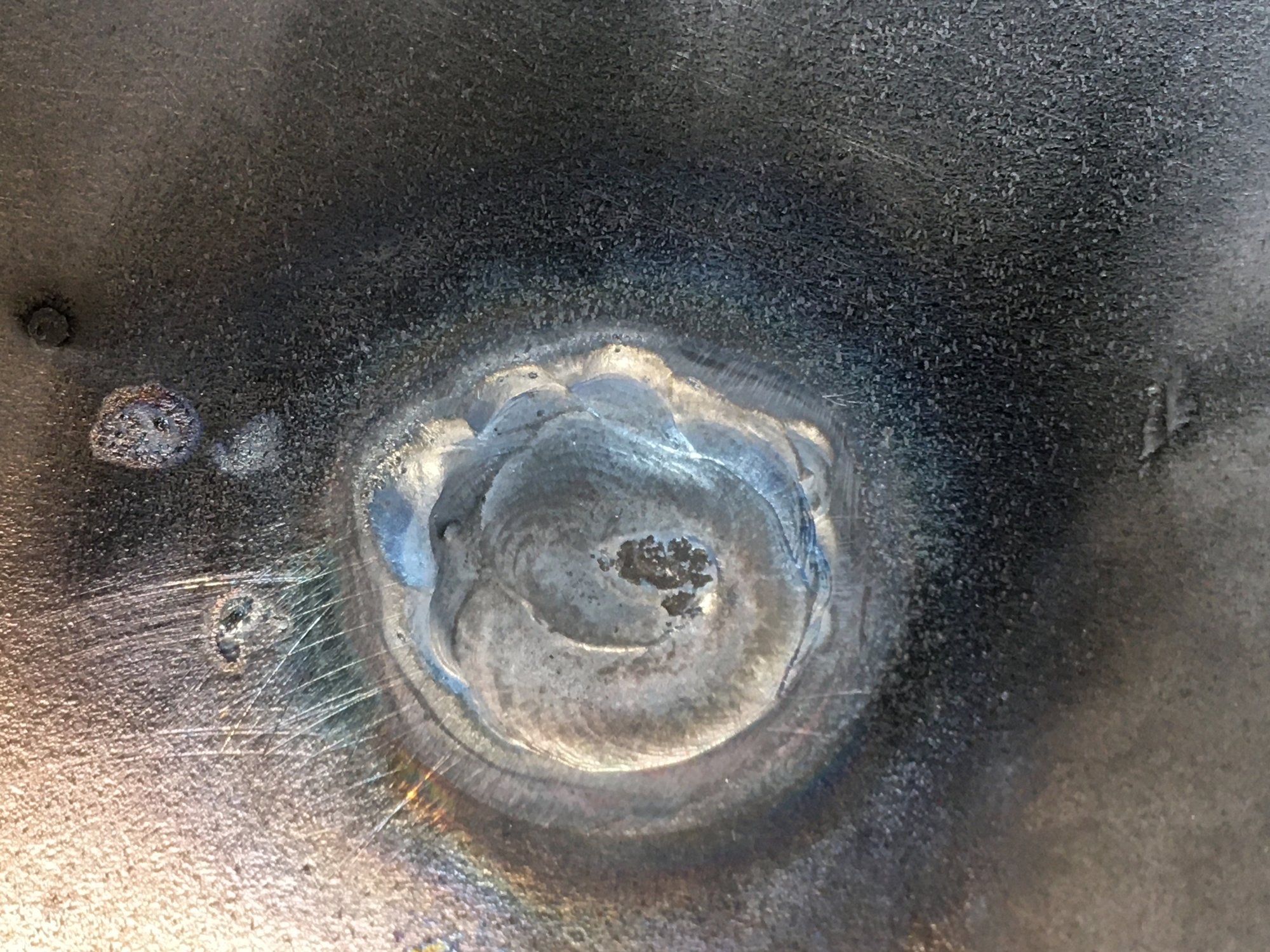

My name's Colin and I have a problem with undercuts... Having worked up the courage to recognise this, wondering if any of you chaps can help me resolve the problem?
To explain, I am pretty newbie. The stuff I'm doing is small/light MS repair and fab in sheet/small gauge tube. And my scourge is small areas of undercuts. Take this example...
This is 3mm sheet MS, which is at the upper end of the material I am working with. I have drilled some 8.5mm holes in the wrong place (another story) and am remediating these. I have parted off some 'buttons' from a piece of bms round bar that push tightly into the holes as little plugs. So it's a very neat, tight fitup. I then run the torch around the periphery and over the top of these small plugs, fusing them in without using any rod. This is at 120A with a 2.4mm gold tip tungsten.
The result is just fine, except for dashes of undercut. The photos show the finished weld, and then after passing a grinder over it to flatten. Before you suck too much air at the apparent scale of the problem, remember that the weld area here is probably 15mm in diameter (it's an 8mm button) and that undercut some fraction of a mm deep. But it's really annoying when you're trying to generate flattish surfaces...
If it helps, I am right-handed and these undercuts usually appear at the back of a weld, or the left of the area I am circling in this case. Is torch angle playing in here? You can imagine on that top photo, that I am pushing the torch anti-clockwise over the top, and dragging it around the bottom.
All help and advice welcome.
Cheers, Colin
