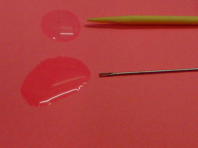

not sure if people have trouble getting superglue just where they want it, but here is my method, and the main thing is not to use it from a bottle or tube. I use a stack of post-it notes for putting a drop or two of superglue on. then if its thick or medium viscosity superglue I use a wooden tooth pick to get a small drop on the point and then apply it to where its wanted. if its watery superglue I use a modified dress making needle to apply it. With a pair of wire cutters I cut the point off the needle (so I don't stab myself), and then cut half of the eye off the needle. The U section is then dipped into the superglue and the capillary action will cause the U to fill up with superglue. You can then apply it accurately where you want it. the eye does clog up, but you can clear the superglue with the tip of a knife blade. I got a pack of about 20 needles from Home Bargains of about £1, although only half of them are small enough to use.

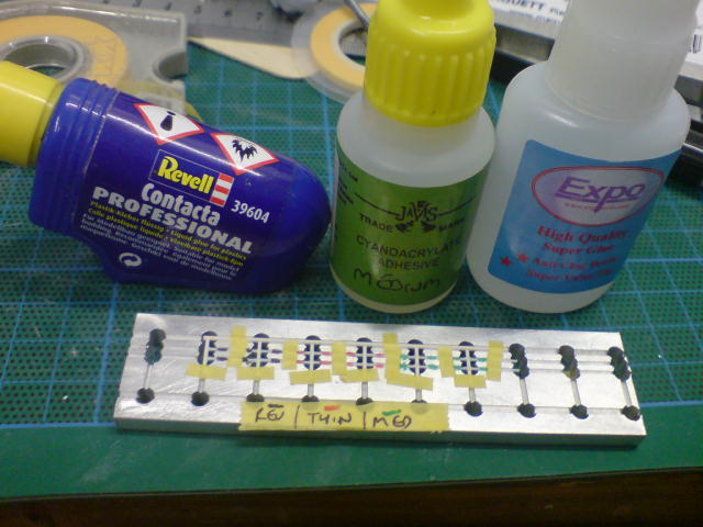

on the attached photo, these model railings were superglued together using thin superglue and the modified needle, and it worked very well. the styrene rods the rails are made from from 0.5 to 1.00mm in diameter. it also shows the jig I made for making them and the holes behind the joint are so that the superglue doesn't wick out and go everywhere due to capillary action.
might help someone to not end up sticking their fingers somewhere they're not wanted.
