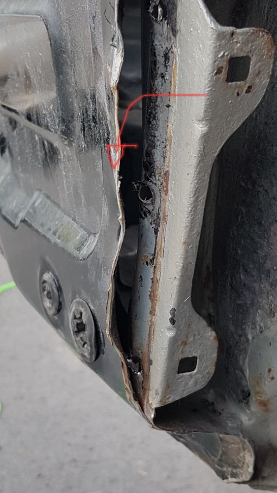

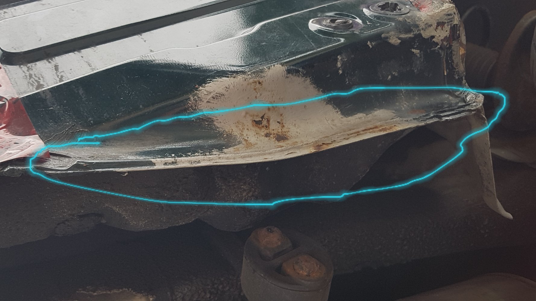

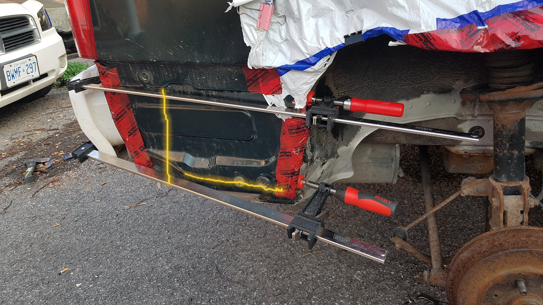

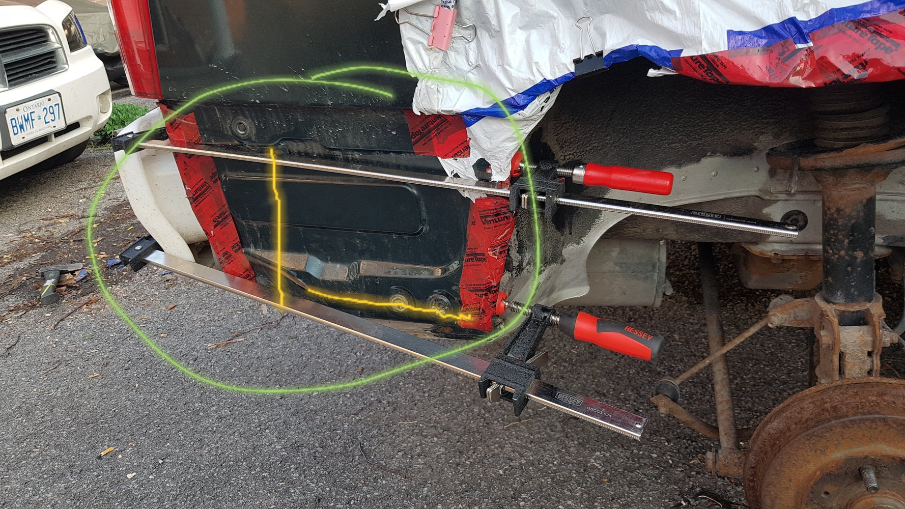

All the person has to do is just weld, no grinding necessary.
I may even just hammerform a new piece of metal using that lower trunk part as a buck (directly on the car), cut out the old 24 yearold metal and just bond/weld new metal in.

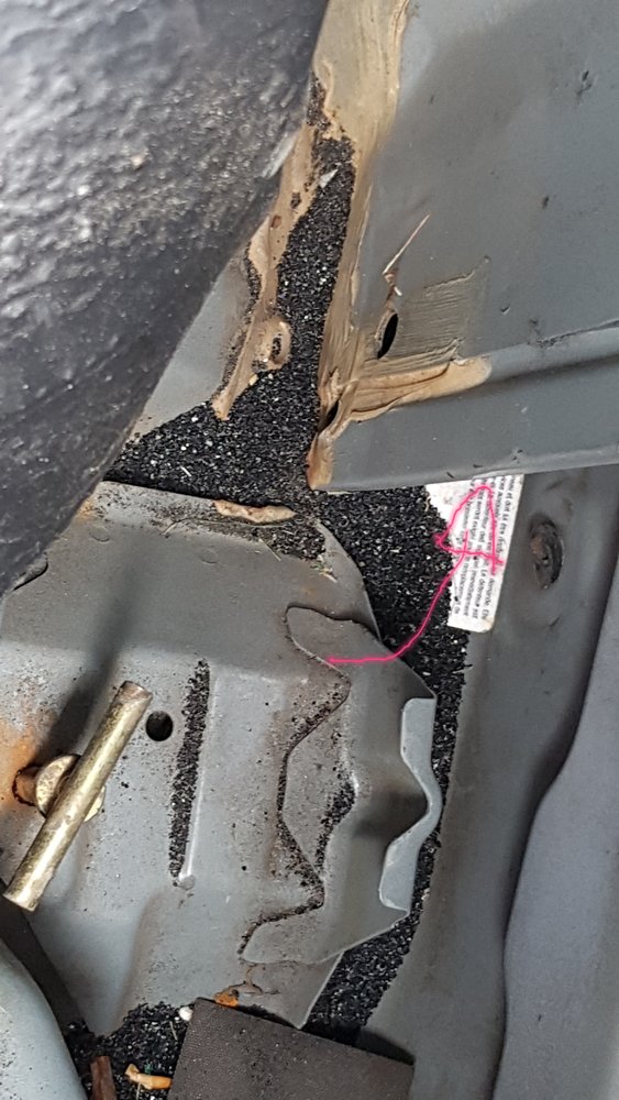

Btw based on my experience chemical rust removers are not effective in removing 100% of the rust.
I always paint rust paint within 8 hours of the area being sandblasted.
