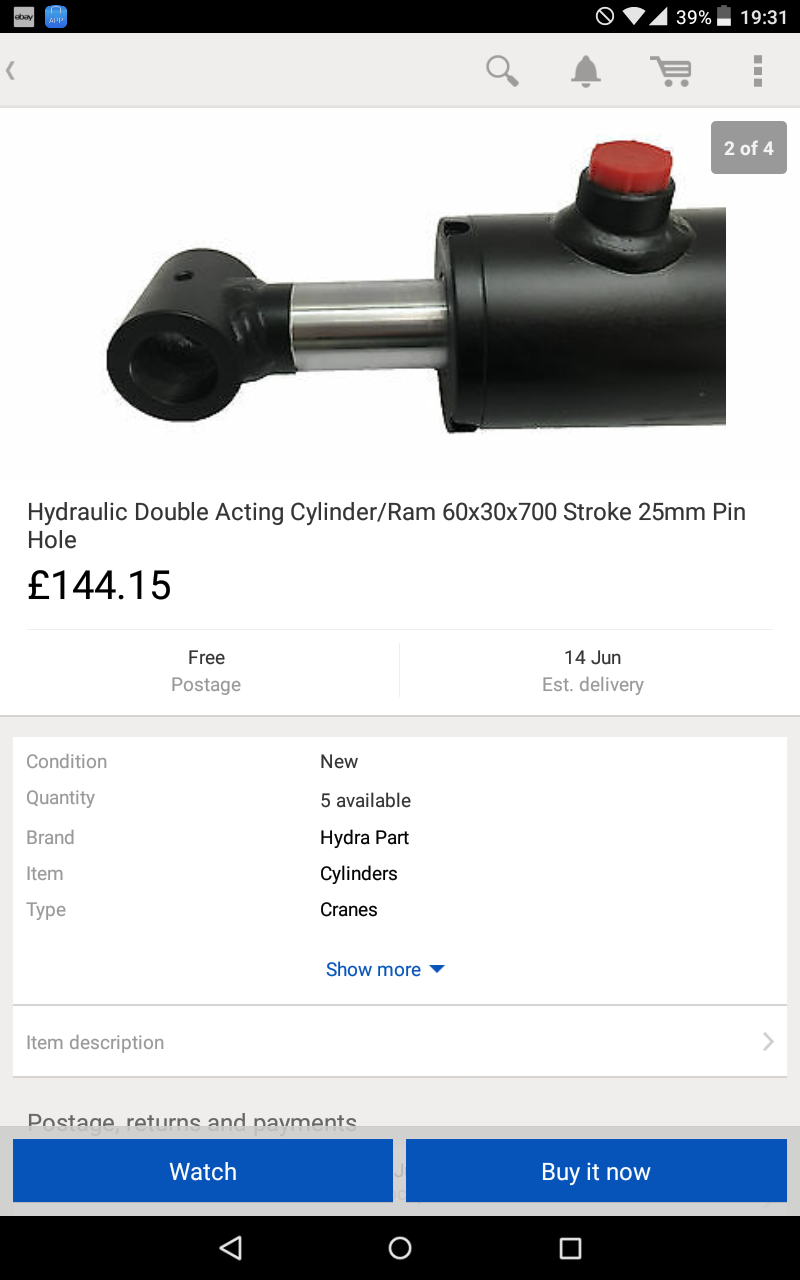

A Adam Marshall Member Messages 489 Location Nottinghamshire England Jun 12, 2017 #1 I am having one of the end bit pin eyes like in the pic machined for me but think I have told him wrong wall thickness I told him to make it with 10mm wall thickness will this be OK? Screenshot_2017-06-12-19-31-48.png 158.7 KB · Views: 56

anto44 Member Messages 1,902 Location ireland Jun 13, 2017 #2 What are you using it for and what tonnage is the ram?
WorkshopChris Member Messages 5,049 Location South East Essex Jun 13, 2017 #3 What is the material specification?
Paul99 Member Messages 606 Jun 14, 2017 #4 Late seeing this but on my flowfit supplied ram the specs are 10t / 40mm ram, 30mm pins with 50mm boss outer diameter.
