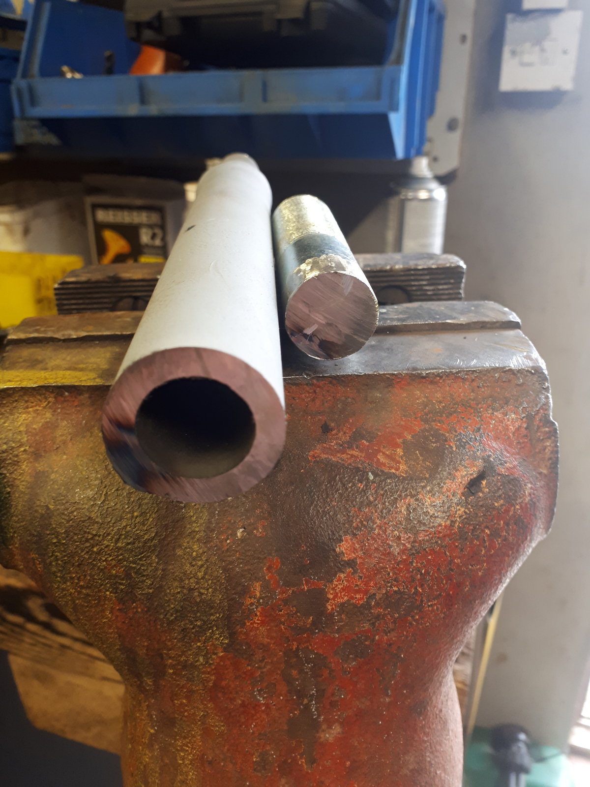

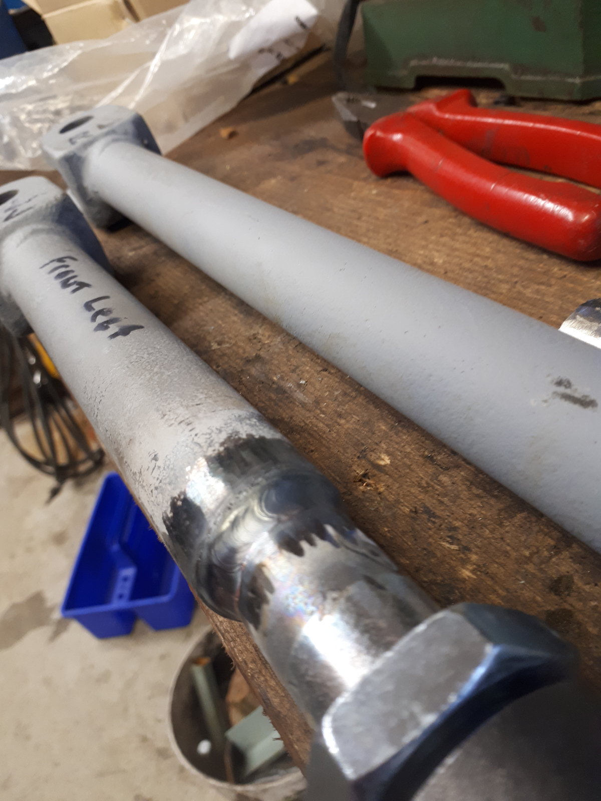

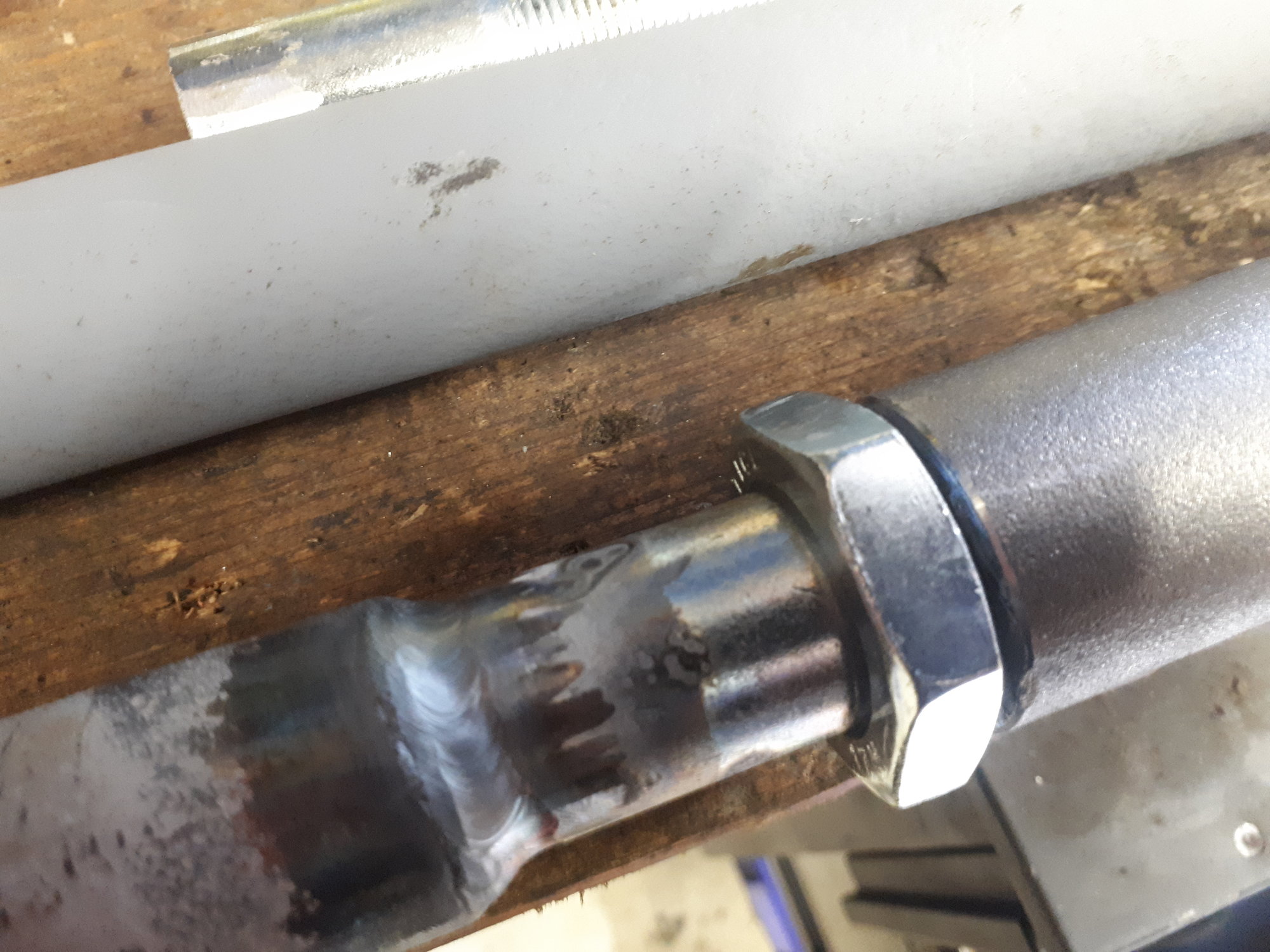

I am making up new push rods for steering joints for an old loader I'm repairing.
I will attach some pictures I have TIG welded 24mm bolts to the old push rod the push rod is 30mm hollow with a 5-mm wall.
I ran a 1.6 tungsten with 1.6 filler at 120 amps I'm just concerned that the finished results could possibly not be strong enough I'm wondering is there enough penetration how do I tell??
Would be better if I go around the weld with some more filler for a couple more laps
I know my weldsare not good as I'm only a beginner so so please don't be too offended!!
Thanks in advance for the advice regards Gary
