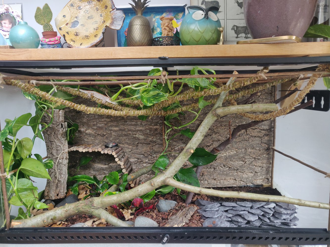

So actually it's a terrarium, but roughly the same thing, it's a glass tank with the kids pet gecko and forest environment. It's will have a ceramic heater, a water feature and has a 10l pond in the corner that you can't see. Those need some wires and tubes routed to them. This time instead of running wires and tubes up and over the back I want to drill a 20mm hole in the side.
I've checked the glass with a pair of polarising filters and it appears untempered.

the tank has been set up and is too heavy to move so I'll need to devise some way to catch the water, maybe a foil sump stuck under the hole, and a 12v pump pouring water over the diamond hole saw.
