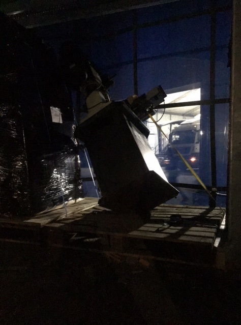

Miracle this didn't go over fully.
Customer did not follow our advice.
Axminster mill - only about 400kg but very top heavy on a small base.
Pallet broke as not ply lined - feet were just bolts sticking down which broke the planks. Would have been much safer bolted.
Strap not exactly great either.
