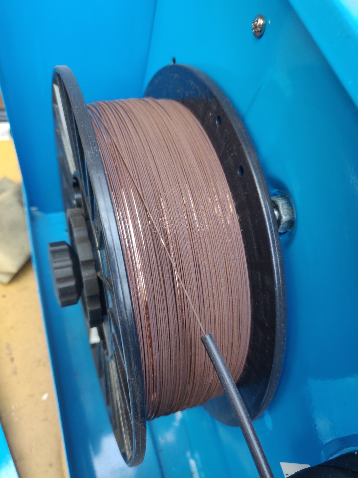

Best to leave it in the welder so you have some control of it, trying to do it off the machine will usually end in tears.Yeah, unroll it (out of the welder!!!) til it’s shiny, or bin it and buy a new one.
get a halfrauds trade card and you’ll save a bit of cash on welding wire, too!
Beware - the wire wil try to uncoil if you cut it to get rid of the rusty top layers, you need to keep tension on the roll to prevent chaos.
