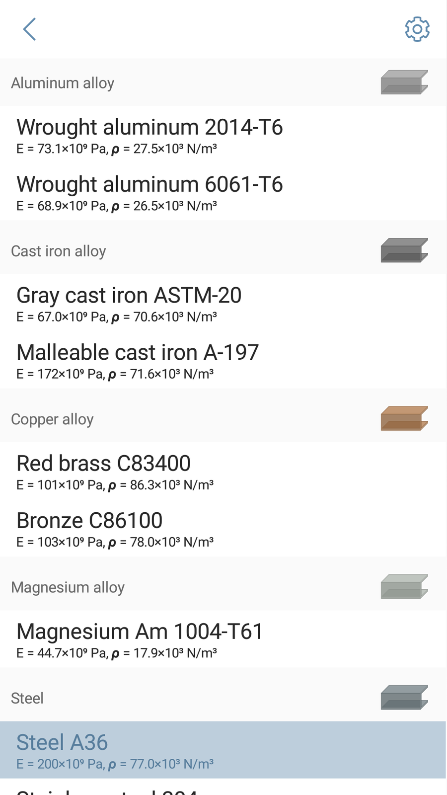

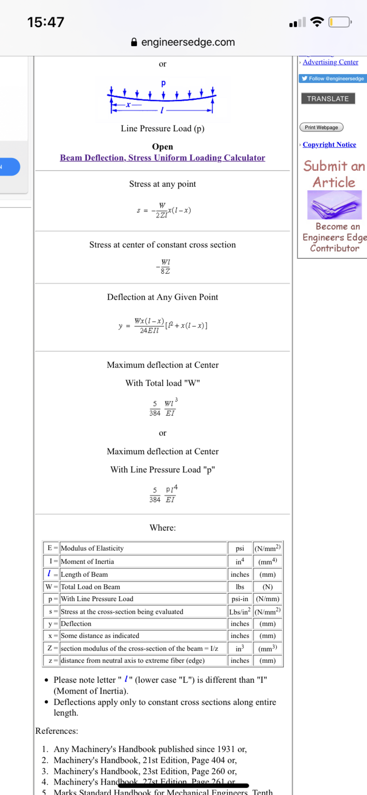

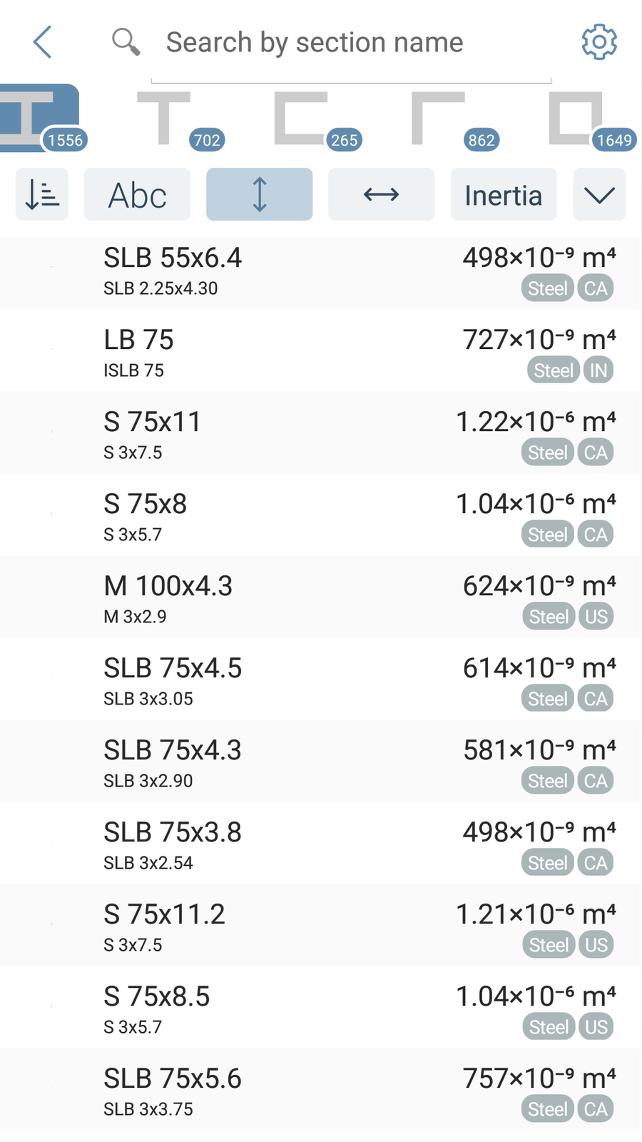

I'm supporting a 6 metre length of 80 mm x 80 mm x 6 mm rolled angle iron pretty much at the ends - (actually at one end and 500 mm from the other) and I'd like a rough idea of how much sag to expect (Brundles yet to deliver the angle so I can't measure it)
This is to hold upright some 70 mm thick sandwich construction sound deadening partition boards a metre wide, the lower end will be fixed to another angle on the floor, and when they are fixed will themselves stop the sag but while constructing I'm expecting to have to put an intermediate temporary support.
