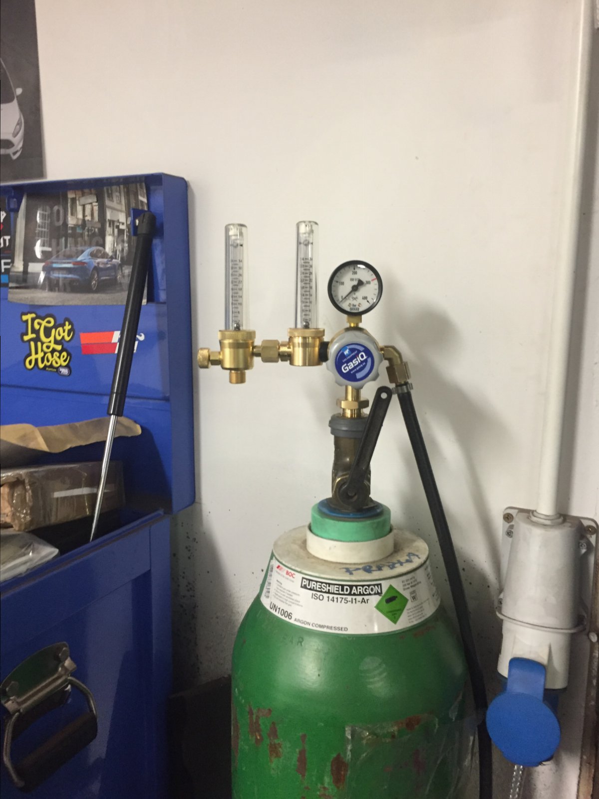

Run it right down till its empty
The needle on the reg will sit against the stop for a good while before the gas actually runs out.
Two stage regs are a must if you use a fair bit of gas.
If you can't Dave then you can tell if the cost of the reg was, say, under fifty quid. It's very likely a single stage then as two stages are more expensive by a reasonable bit.Thanks, i'll bear that in mind and see if i can find the reg booklet somewhere.

Tend to just do a lot of tacking and short runs when right at the end. Minimizes what you might have to grind out from porosity.
