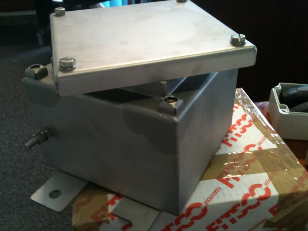

I'd be interested to know your combined thoughts on this. I'd like and would appreciate your views on how long this box will take to tig up. its already lasered and foldered from 2mm 316, and approx size is 150 x 150 x 120, plus cage nuts, and 4 runs at 150 each accross the mounting straps.
No prizes, just trying to estimate weld time......

), I'd probably have 2 people on it, 1 tacking 'em up and the other just welding, probably alow 7/10mins for the guy tacking and 15/20 mins for the bloke welding (factoring in going to the bog, stopping to light ciggies, change gas, sharpen tungstens, take a sip of water etc..). But I guess you'd have to factor in the 2nd wage, against the time saved/increased profit.
