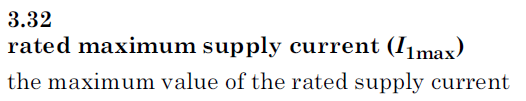

Except when it doesNo it won't include inrush current, it's maximum current it will draw in normal operation.
Inrush will be dealt with breaker type b, c, d,.
You won't get an inrush current as it's variable.
The effective is the RMS value I believe
POWER I-TIG 200T - Everlast Europe
When it comes to DC TIG welders, you won't find a more feature packed, performance driven machine than the Power i-TIG 200T. It's user-friendly interface is thoughtfully arranged, with an intuitive design that is charachteristic that people have come to expect from Everlast products. The Power...
I still don't understand what problem is trying to be solved by the OP. I1Max is literally maximum current as defined by the manufacturer - so what other answer are we looking for
