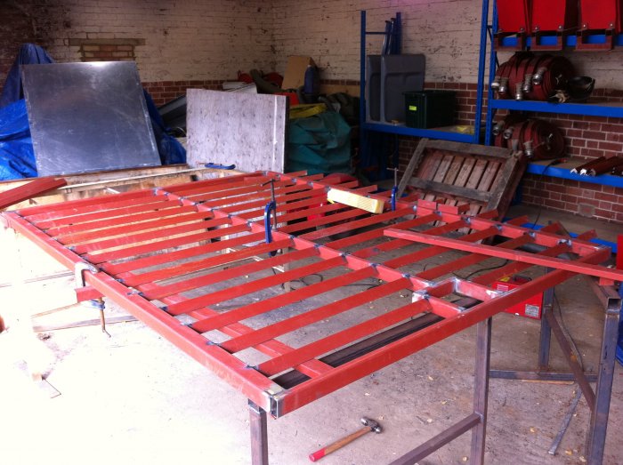

Don't suppose you have acess to a Lathe do you? you can get the center spot on using the tailstock center drill.
I made the mistake of marking out the centres by measuring from the previous to the next...this ended up with the last marks being out....All the errors were compounded![]()
Just make them close enough for a small child not to get their head stuck. No-one is going to mind a different gap at one end in the great scheme of things.
