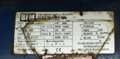

it's an old SEM 0.25HP 240v Single phase.
It has 5 connections:
A1:
Black into motor
another Black into motor
Neutral from Mains
A2:
Yellow into motor
Live from mains
Z1:
Dirty Blue or green into motor
Blue to Capacitor
K1:
Black into motor
Blue to capacitor
Z2:
Yellow into motor
Red into motor
another yellow into motor.
cover plate says:
A1 Neutral
A2 Live
"To reverse rotation change over blue & yellow leads"
Can anyone help me with this?
