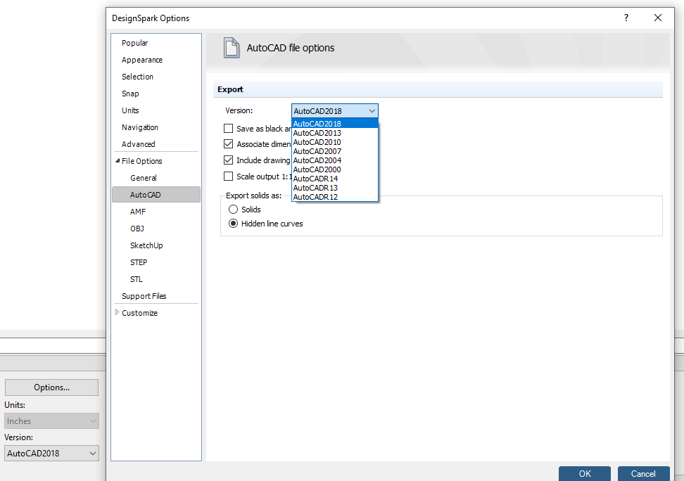

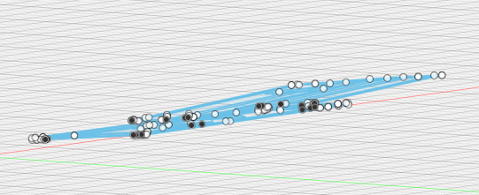

I did a bit of googling & it looks like the DXF might be a 3D one. If you try exporting that, I'm happy to see if it'll import elsewhere.

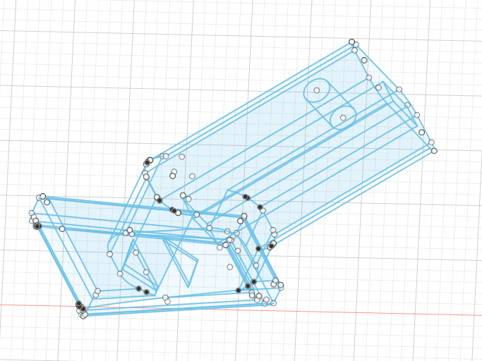

That one doesn't seem to work unfortunately. Even Fusion 360 (which, being an Autodesk application, should be able to read any DXF) just loaded it as a flattened image:This was from selecting .dxf and then the STEP option.

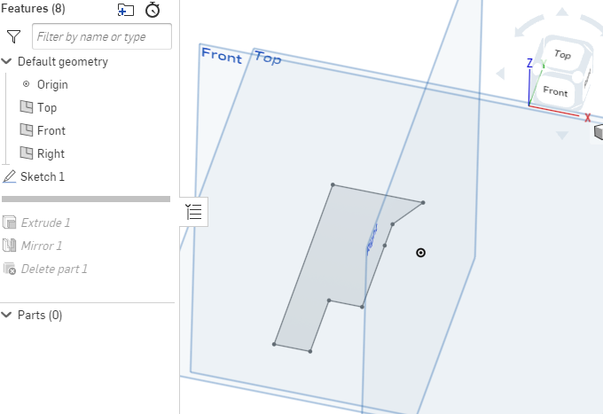

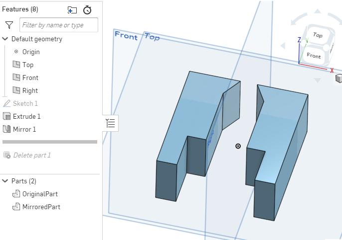

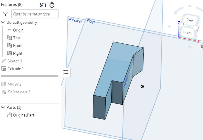

In the ones I've used, with a plm system to control the data, if you "delete", then you "delete" - it's gone, there is no history. If you "hide" or "suppress" (which is what most seem to do when you tell it not to keep the seed part), then somewhere, it reappears, sometimes in the drawing, most often in assemblies used in bigger assemblies, then popping out again when dragged into other systems.That sounds strange. In the CAD systems I've used, the deletion of the original part is an operation in the parametric history like any other.
If you want to change something, just go back in history before the delete, edit the op that you want to change and then fast-forward again. The mirrored part updates as expected.

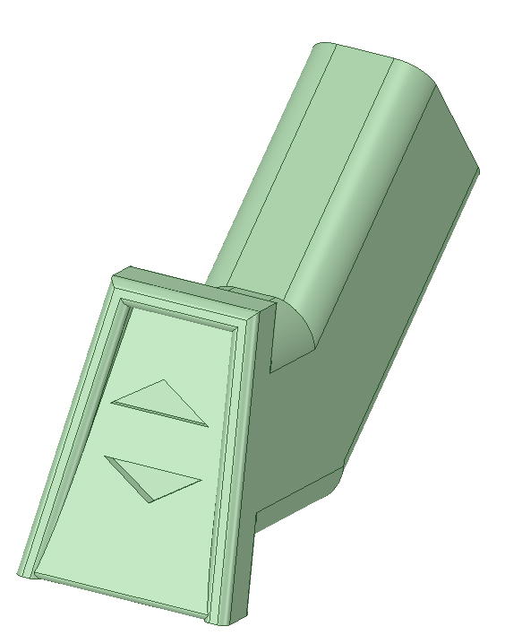

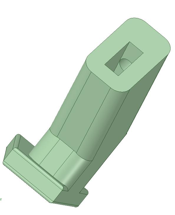

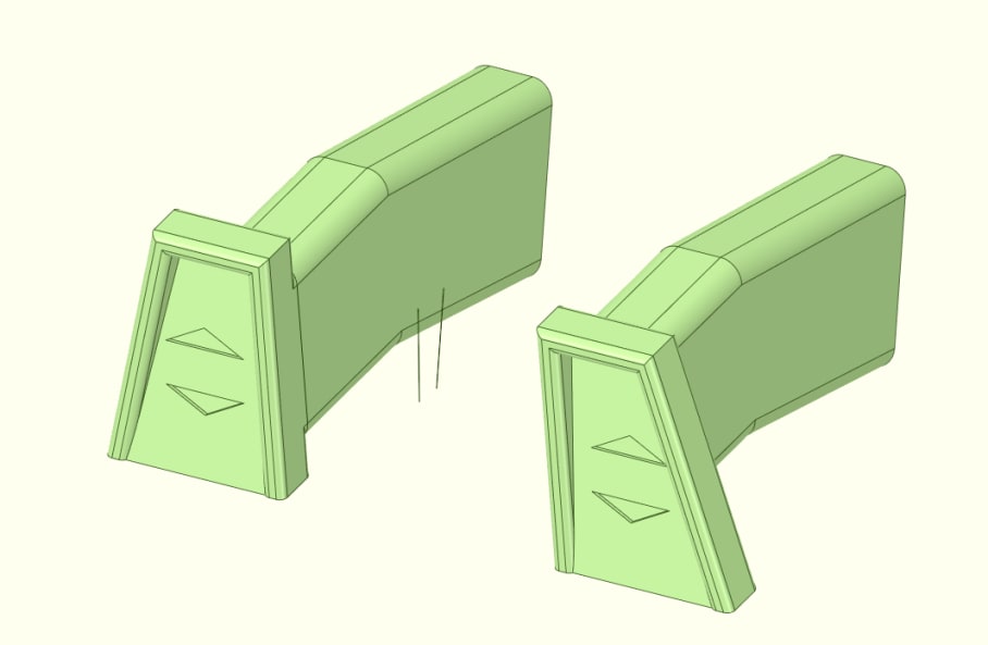

The answer from me does actually use the mirror line in sketch planes - except not from the beginning.
Like Jacant, a simple copy and split body is exactly right but I'd then do it slightly differently - all fairly easy - but i'll admit, not as easy a a direct 3D mirror copy command.
In a sketch, the geometry on that sketch can be used to project onto itself obviously, but with an active mirror line it will also create the basis of a mirror sketch - same for the 2 arrow shapes. In sketch plane, when you have the reflected curves, before exiting the sketch, undisplay the solids, off the mirror line and delete the unnecessary reflected curves. Exit sketch, display the solids and pull the surfaces to create cuts, protrusions etc.
hope that helps.
In V6, there's an alternative upgraded solution to 3D solid body mirroring - it will work for some users, but not for all users no doubt - they'll still be the existing standard principle of using the mirror line in a sketch and progressingly building solids etc, which works very well - for instance, 3D mirror relationships on mirror symmetrical faces can be established automatically even though they were not initially considered. But yes, I'll concede it takes reading how to do. DSM has a tutorial section in which the principles are outlined - the RS YT video's , this one explains...(4) DesignSpark Mechanical - Mirror symmetry with construction line (PART 1) - YouTube
