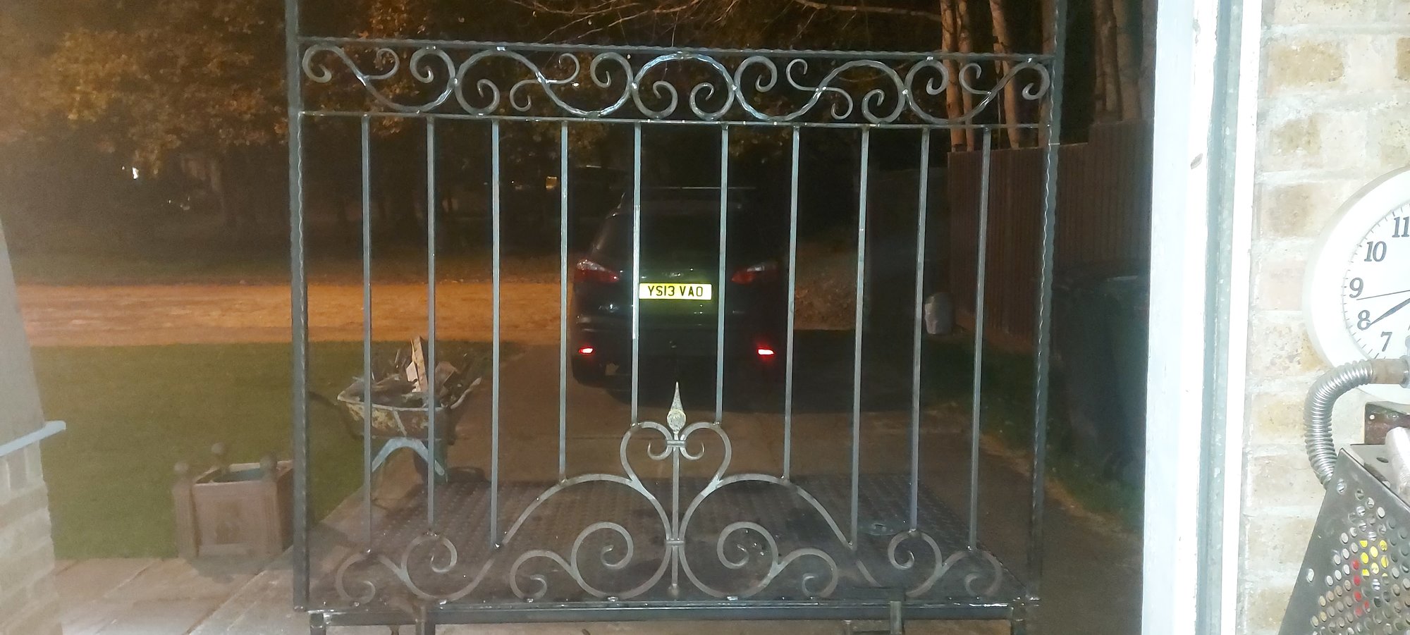

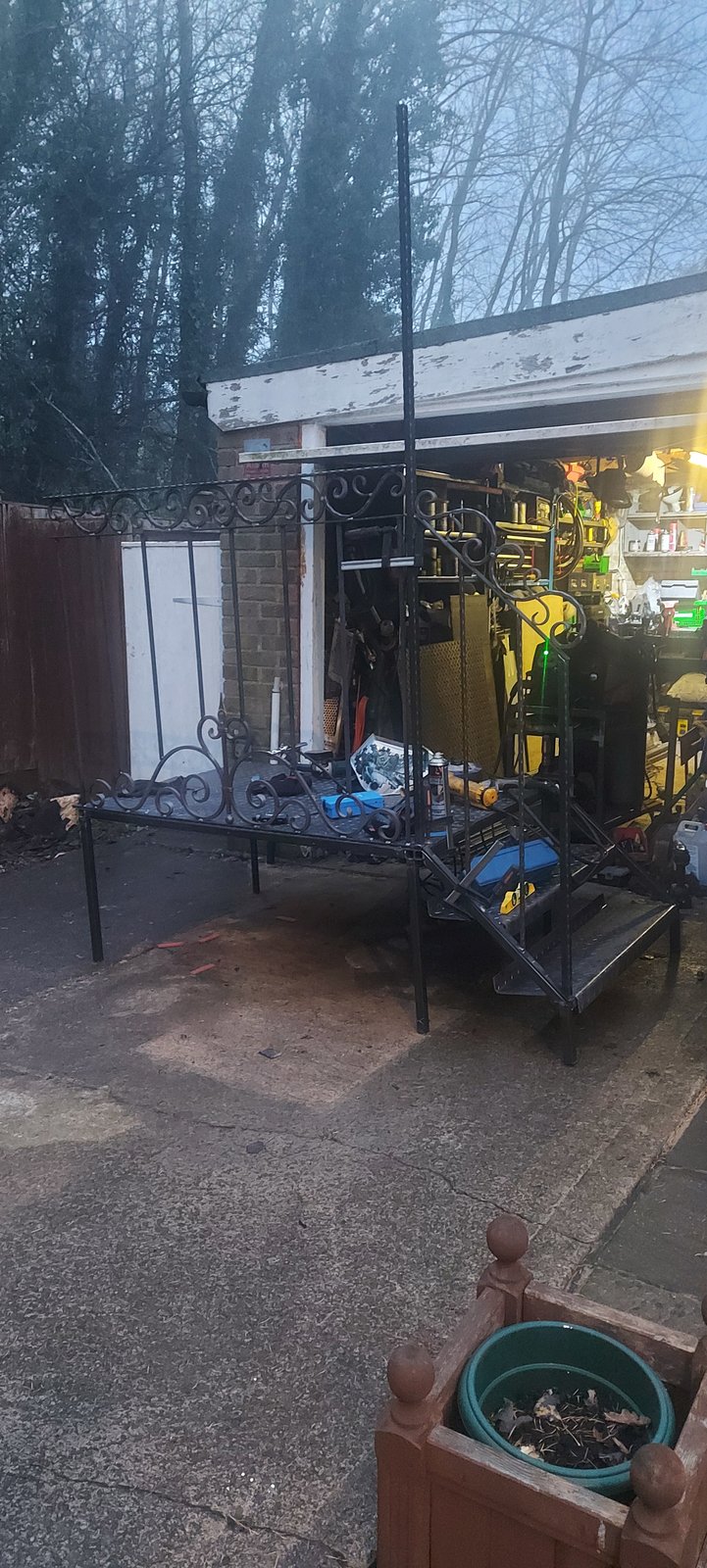

Hi guys, im making a set of steps with a platform and handrail for a static caravan,
I'm having to make it collapsible as to build it complete would mean it won't fit the access I have to the caravan,
I'm not finished yet but the handrail is a little wobbly when its put on, can you think of anything to make it more sturdy.
In hindsight I should have made the legs be the support for the handrail and roof but I'm past that stage now
