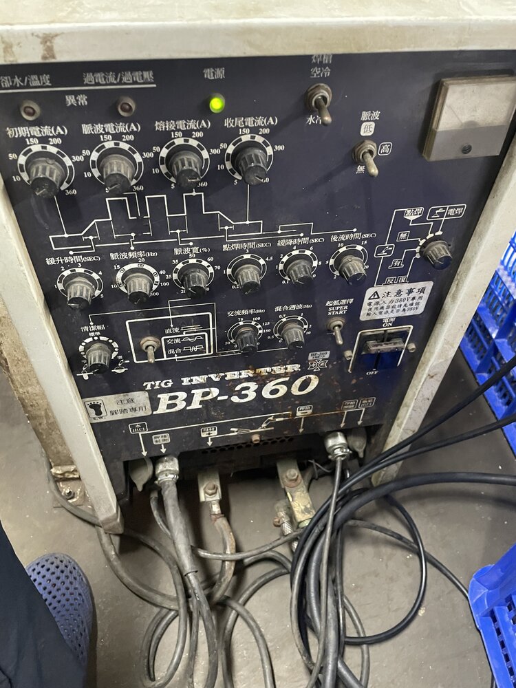

The tungsten end will ball as soon as the arc starts, provided the machine is delivering AC, at a reasonable current for the tungsten diameter.i
im just learning to welding,can you give me some details about thisThe tungsten end will ball as soon as the arc starts, provided the machine is delivering AC, at a reasonable current for the tungsten diameter.
Indeed, if you have so much cleaning the end is vibrating you have too much, or too much amps for the tungsten, or both.In my limited experience the amount of cleaning action is what causes balling.
Yikes, there's a lot of squiggly writing on that machine.....love the safety boots.....
yuckIt looks very similar to a Hitachi machine we used to have at work.
