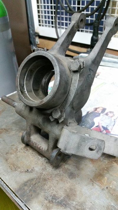

Heat and patiences mate..i wouldn't be to worried about using heat..you will do more damage with a 50 tone press ...

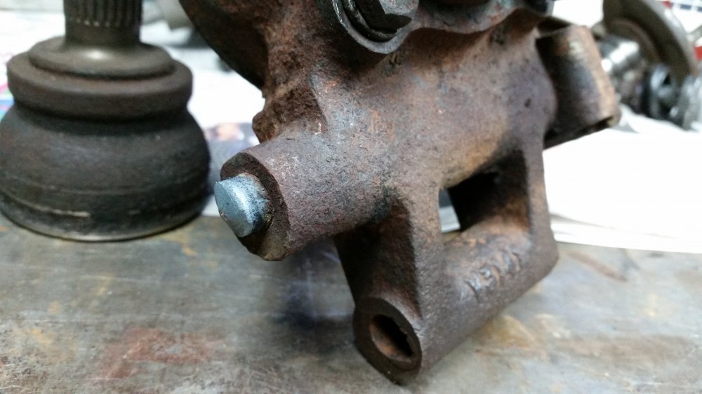

As there is a welded bracket on one end. Which sits against a lug.
It can not be twisted.
What I mean is it is not made from cast ironI thought it was a forging rather than a casting, especially as the top arms that carry the transverse leaf spring are not that thick, castings are not strong under bending forces.
