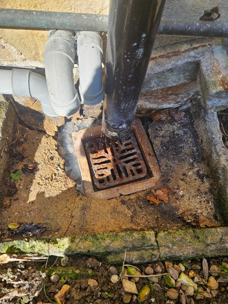

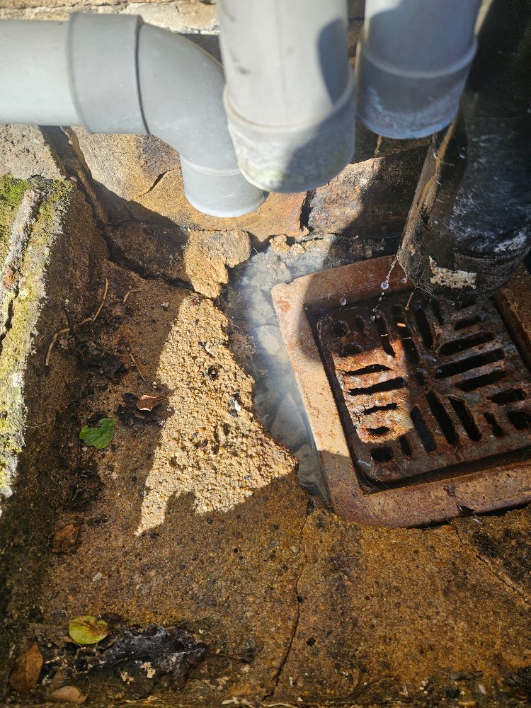

Exactly that .Whats the best way to fix this. Dig it out and cast another from quick set concrete of another way?
A funnel is a great idea. I did wonderExactly that .
Normal concrete will be fine if you stuff all them pipes in a funnel - straight down the gully . So the conny has a chance to set .
I need my gimp suite as it is.If a funnel did not fit the spread of the pipes, a layflat plastic tube zip tied to each one would direct the water.
This is the retail version - you could invent something cheaper from stuff around the house (cut the legs and arms off your latex suit).
Proguard Temporary Downpipe - 150mm x 165m | Wickes.co.uk
Proguard Temporary Downpipe - 150mm x 165mwww.wickes.co.uk
Wow that will work. All I need then is a wet base to set that into.
