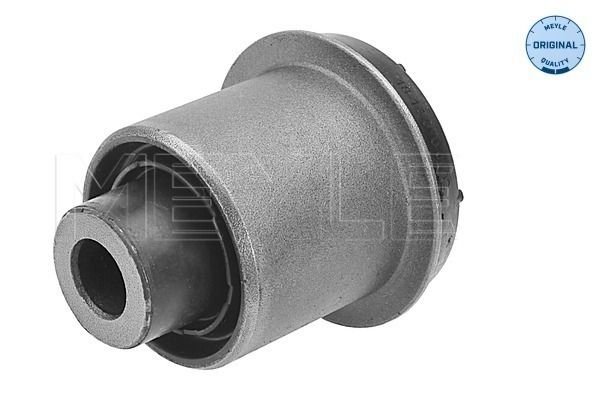

Replacing with polybushes..
Think very hard before doing that on anything other than plain simple bushes with simple loads on them.
Modern Jaguar suspension bushes are all far from simple and none have simple loads on them.
We have used polybushes on other vehicles with a modest degree of success - Series Land Rover leaf spring bushes - where the originals were plain simple ones.
We have uses them and regretted it - MX-5 suspension bushes - and removed and replaced with OEM in very short order.
