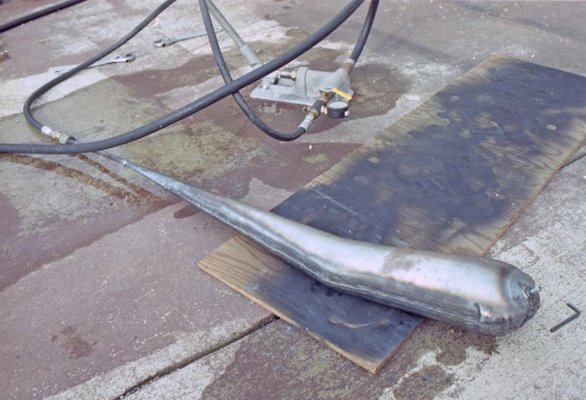

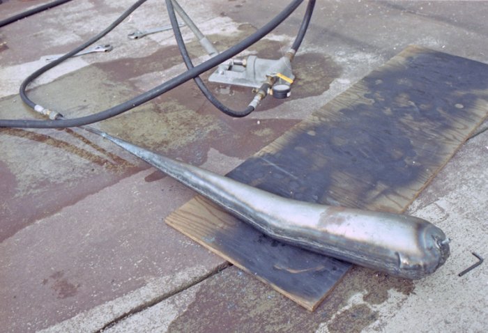

Does it have to be steel? Aluminium would be easier. Perhaps making a tube the smallest diameter by the full length, a hardwood plug to reach half way into the tube, anneal one end at a time and press/dress the plug into the tube. It may need annealing more than once.
