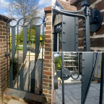

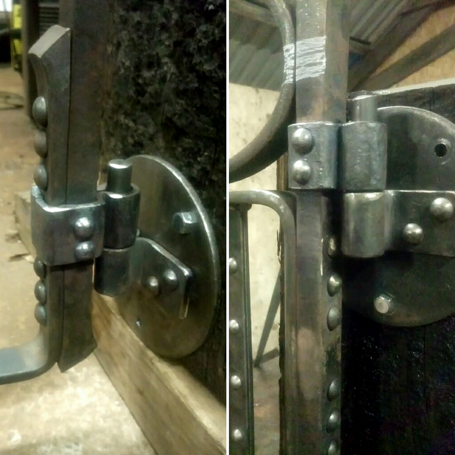

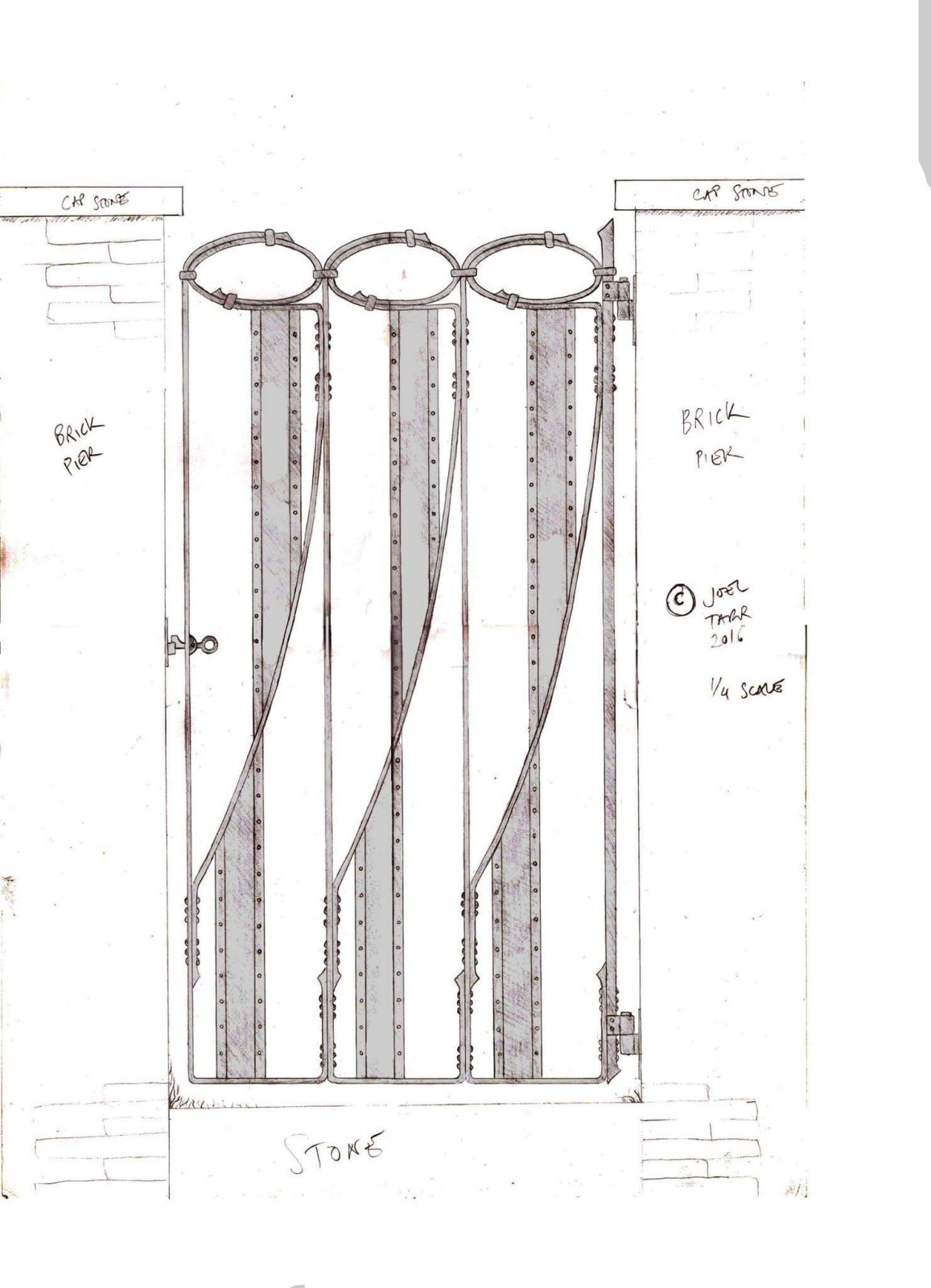

I am working on this Art Nouveau/Industrial gate design which is full of rivets and upset end finials. I've used it as a vehicle to produce a few videos, mainly on riveting, but also accurate bending of steel around jigs. The videos are very much intended for newbies and hobbyists looking for some general info, the videos aren't slick by any means but they hopefully contain some useful theory/techniques. The gate itself is almost irrelevant and if nothing else, you can enjoy watching me struggle.
I am self taught and I've never done this before so any viewers are effectively learning at the same pace as me. I don't know if my methods are "industry standard", but regardless, what I'm doing is working and should work for others. My setups are very low rent and duplicateable, (if that's a word?), I don't have any specialist gear other than an oxy propane gas torch and MIG welder.
There will be a video of collar making using my very basic adjustable jig under my flypress (this jig can also be used on an anvil, for those without a flypress) when I get to the collaring stage.
Hopefully these are of use to someone...
Trial and error figuring out rivet tail lengths:
Riveting setups and heating rivets:
Cold riveting small rivets:
Upset finials and bending using jigs:
